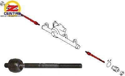

is it anygood? im a little confused by this hicas thingy. as far as i can see the track rod screws into the actual hicas rack, so if it screws in, how can there be play at the rack side as thats where mine is loose. sorry for all the questions guys, im still learning. If it was anything to do with an impreza or a celica gt4 then i would know just about every last nut and bolt on them but this is all very new to me!

There is a ball joint inside the gaitor and a ball joint in the hub where the track rod connects to. Il find a pic for you.
