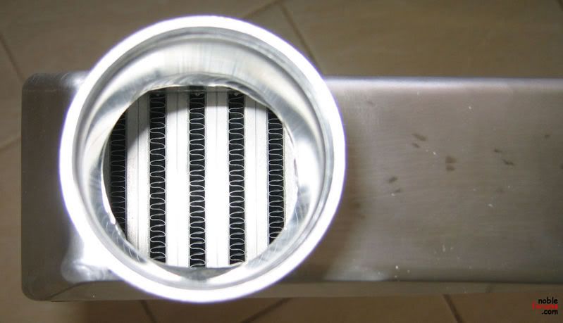

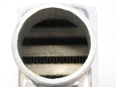

Dont forget that just because the intercoolers are large in size means they are any good. You also have to think about the internal design of the 'cooler.
Something like this (Godspeed)
Is going to be nowhere near as efficient at cooling air as something like this (HKS)
as you can see, the difference between the fins on the inside of the cooler are fairly different. The HKS has got nearly double the amount of fins as the Godspeed, which equals double the amount of surface area, which in turn makes it far more efficient at cooling even though its a smaller unit. I have a pic somewhere of the internals of a Stillen SMIC for the zed, which again has easily double the amount of fins of the HKS
