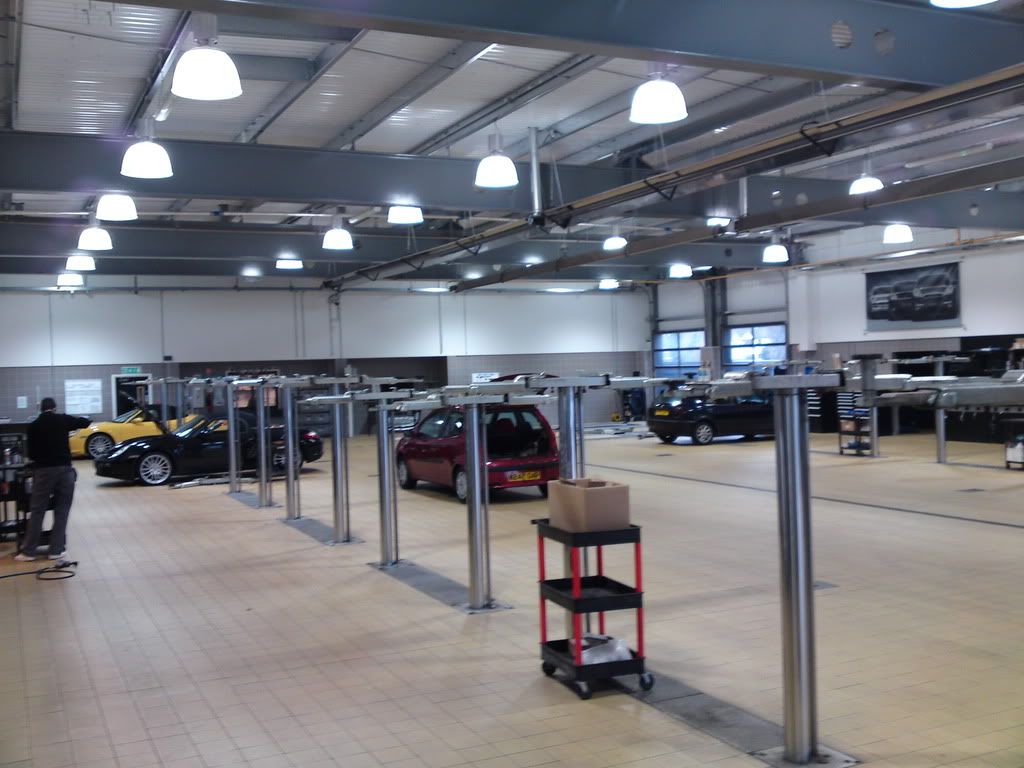

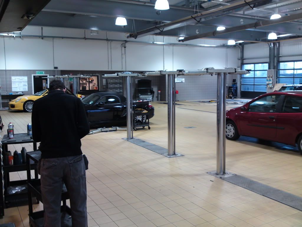

They were easily pressed out in a proper press of course :D thanks to my mate who works for porsche in hatfield....:bow::bow:
Now this is what ya call a workshop:

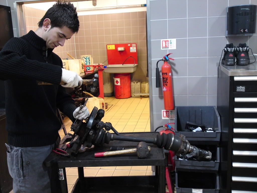

One of the driveshafts was siezed so that was also pressed out rather than mucking about with a puller/hammer etc

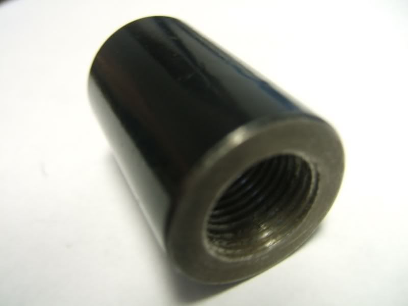

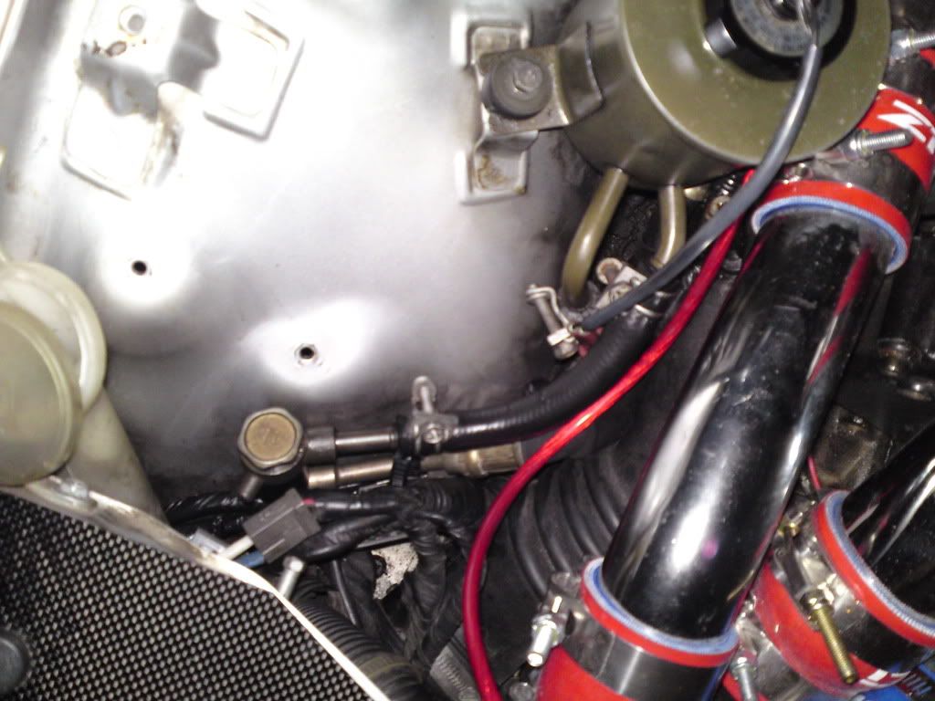

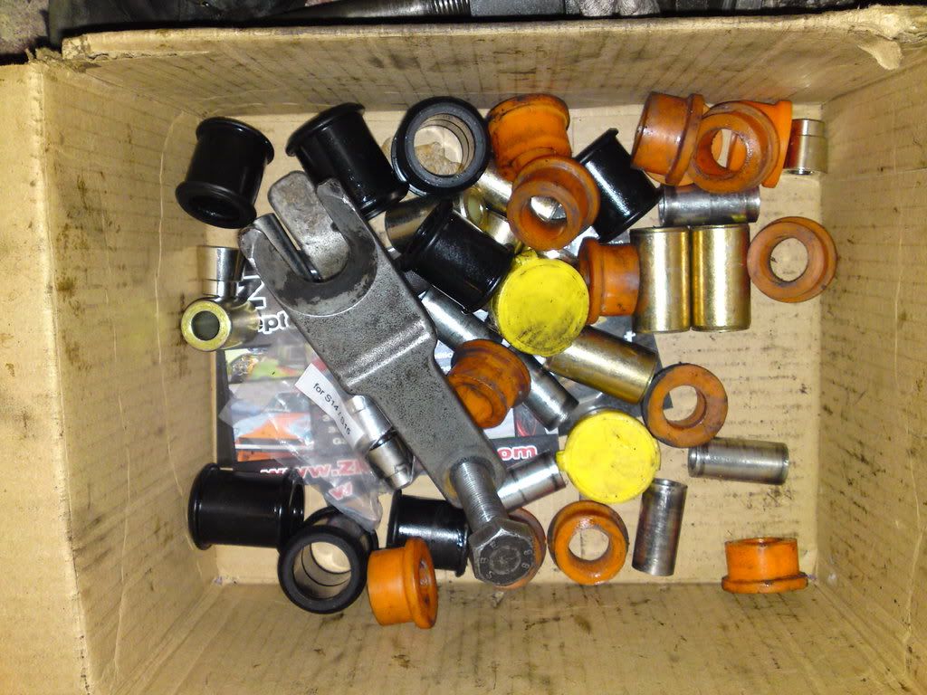

anyway The only downside was finding something to loop the pas pot back to the pump without chopping hoses and fiddling around, so i bought this along with my enegy bushings from Z1motorsports:
I still have to get round to removing all the unused hicas pipes. They will be fine for now.
I had previously fitted driftworks poly bushes in the rear hub but driftworks do not supply a bush to replace the lower shock bushing so i went ahead and bought the whole energy rear end kit which wasnt alot. To be honest i prefer the enegy bushings as they are slightly stiffer and come with that nice yucky sticky grease :D So i switched them all round.
Spare bushings anyone?

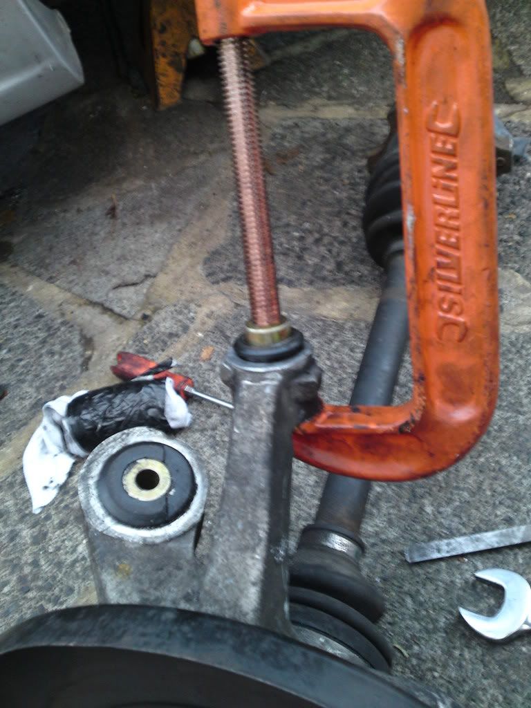

Energy bushings do require some force to press in as they are not a two piece bush like the driftworks type, it wasnt too much trouble, i put together something to sqeeze them in with, a long thick bolt with a nut and some different sized metal rods to press them in.
To sqeeze the bush rods in i used a c clamp which worked lovely
