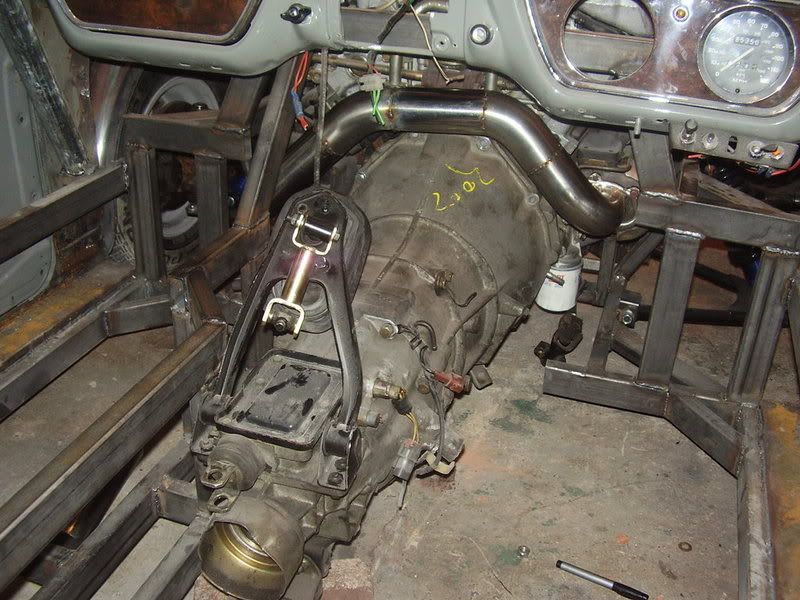

Maybe better if you look at this first...
This is just a rough mock up of tubes at present and by no means the final design. But see the right hand downpipe going over to the left, this would then join with a form of Y piece at the left side downpipe. From there it can run through the car as a single tube.
I know with good old fasioned exhausts (not upto speed with fancy new stuff, but getting there!) that its best to have all extractor pipes of an equal length. Is this the same case with Turbo downpipes???

just remember that an exhaust is tuned by length and diameter..mess this around too much and you could lose top end or even torque..my advise is to call powerflow or other exhausts manufacturer.....

No pic sorry but they're the same length up to the middle of the car then go into one pipe, not as soon as your on about.

I will probably just *******ise something from bought downpipes and home made system, save the welding hassle and worry that the back pressures may be to pot.

To answer your original question then.....
All single exit pipes join after the cats, this is because there is no space to join then up before that area.
I think you'd be ok joining the pipes up by the turbos, a turbo exhaust system is not a very critical thing compared to a highly tuned N/A engine.

How about tube diameter for the main system then? Also would it be fine with only small silencers? My Anglia Cosworth Turbo lump has a 2.5" tube with mid box straight through silencer and that runs just fine. I also run a Mk2 Escort with Yb Turbo and that has two small silencers on the 2.5" tube, also fine for the job. Should then be sweet for a relatively smaller twin turbo set up then? How do these ZX motors like to breathe?

The biggest restiction on a turbo Z exhaust system is the cast manifold. For the power you're chasing it might be advisable to buy some mike smith manifolds (or copies;)) and go from there.
I would think 2.5" downpipes would be fine, just remember to make the single pipe 3" or 3.5" diameter. As for silencers, again they're not critical. Just make sure they're straight through design not composite baffle and you'll be ok.

Dunk, going twin turbo mate. Also as little silencer as possible! I will just make new down pipes by the way, not sure yet what the connector is like but should be easy enough to buy the right type and size? Probably go for 3" right through also??

3" should be fine, assuming you're going for larger turbos (for 500hp) then it will be perfect.
