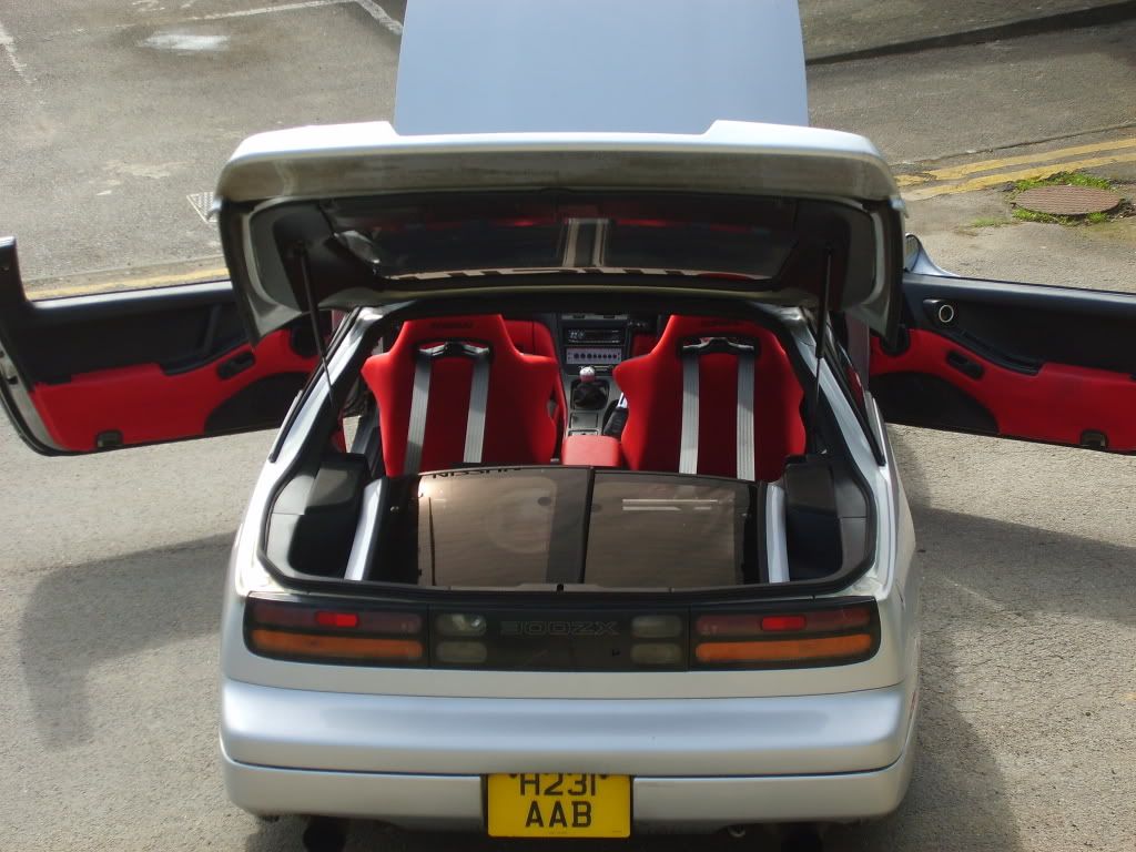

aha i think i got it.
I can weld two more of theose plates to the rear boot in the centre the screw in these eye bolts http://cgi.ebay.co.uk/Harness-eye-Seat-safty-belt-eye-x-5_W0QQitemZ280286935021QQihZ018QQcategoryZ72229QQtcZphotoQQcmdZViewItemQQ_trksidZp1742.m153.l1262 and attach straps to these that way it will only be about 10degress angle from the seat?
This way the straps will pass through the centre of the car and rear passengers on the sides wont be too affected. Im talking about 3 strap harness btw so i only need one for each side.

its still going to be in the centre of where your rear passanger will sit, 4 or 3 point harnesses fitted properly will stop people sitting in the back.
if yours is a J-spec then im pretty sure you wont have a bolt hole in the B pillar as your belts are in the doors.
if you imagen these as 3 pointers the shoulder strap will be in the middle of the two each side in the pic...... no room for rear passangers heads safely

have you got another photo of the brackets you made?
