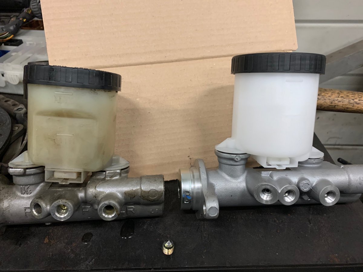

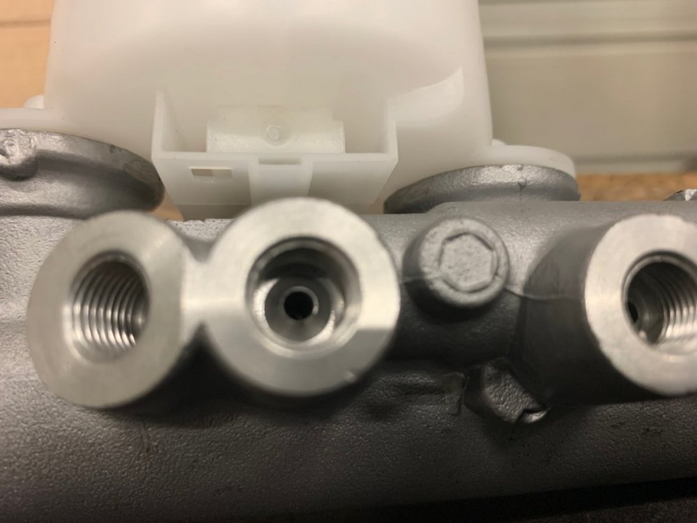

Everything posted by Animato

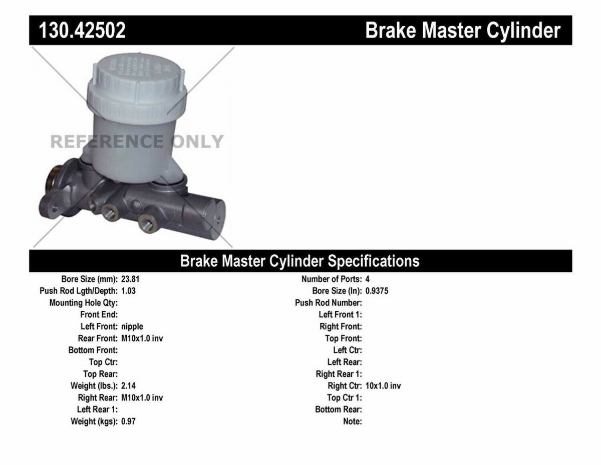

  1. Correct, this seems to be it ! Now I need to find some with the correct diameter and pitch (M10 x 1mm). Let's see ! Thanks a lot for the help so far !
  2. Yes it does, as usual (we don't fully see it though on the photo of the 1st post, I admit !..). Problem is really, that the small conical shape you have at the end of the thread, is inverted compared to my old BMC ! meaning you can screw the old OEM plug, but after 2 turs you get in collision with this inverted conical shape = no possible fluid tightness
  3. Thanks for the answer. I supposed so to, but cannot help to think there is a specific shape on the tip (see first picture of supposed Nissan plug needed)... The technical datasheet of the BMC I got is as follows. "Right CTR" is given at 10x1.0 inv. I assume this means M10x1mm. Inverted must mean here, that the cone in the BMC in convex, and not concave as on my old OEM BMC.
  4. Hello everyone, Help... I am in trouble following the purchase of a brand new Brake Master Cylinder for by USA 1989 NA Z32 : the middle plug was not supplied with the BMC, and my old plug (from my OEM BMC) cannot be fitted inside as the geometry of the cone differs... Detail below : 1st photo : The 2 BMC - LEFT : my old OEM BMC + its middle plug (conical "convex" shape) - RIGHT : The new Nabco I just bought, delivered without center plug... 2nd photo : detail of the new Nabco I just bought : we can see that the hole has its conical shape inverted, making the fitting of the old OEM plug impossible. In conclusion, I need another "concave" plug. Would anyone have this somewhere ? I would be really grateful, as the car sits currently in the garage... Thanks a lot !

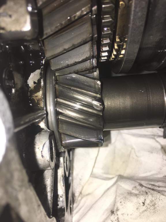

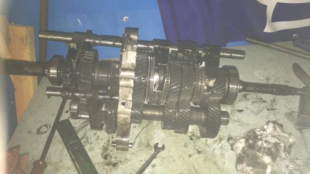

  5. Good morning everyone, Recent owner of an 1992 NA manual Z32, I am currently facing gearbox damage issues : after repeatedly hearing loud rattling noises in 2nd and especially in 4th gear, we decided to open up the GB and check what was going on inside. Sadly (see pictures below), we saw that many parts were badly damaged. Does any of you faced something similar, and know what could be the reason of such an abusive wearing ? For information, my Z is a 1992 SWB NA of 130000 km, freshly imported from Japan this year. This has been spotted right on arrival. Clutch is new already. What would be your advice for the next step ? would you rather either : - go for an used gearbox (I assume it is the same of the TT GB ?), or - refurbish this one ? Thanks a million ! :)

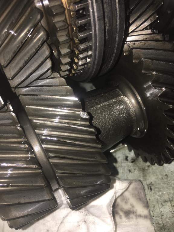

  6. Hello everyone ! I finally got some fresh news from the garage regarding the gearbox... well, doesn‘t look so good indeed, the fear box is badly damage on 2nd and 4th gear shafts, as you can see bellow. We are checking what is the best solution now, but looks like I‘m good for a used gearbox..! Cannot see what caused so much damage, the car has only 130000km :( I‘ll be glad to hear any advice from you :)

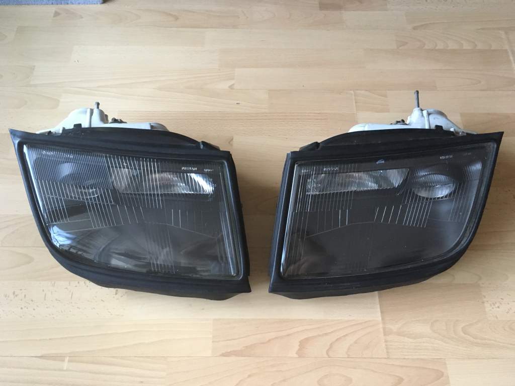

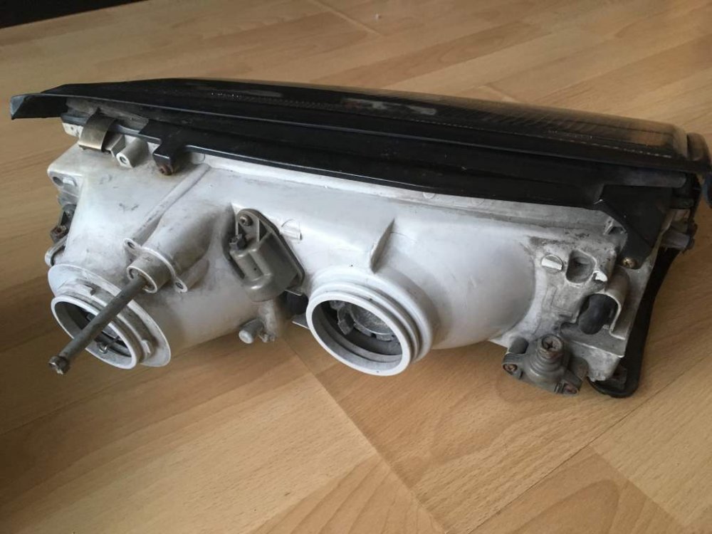

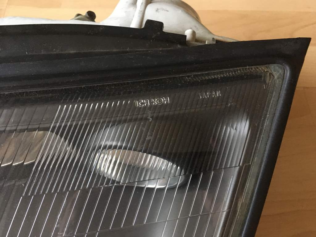

  16. Hello everyone, I have for sale a pair of OEM RHD headlights : - LH : in very good condition, - RH : in good condition, with one of one part of the plastic housing on the back being broken next to the adjustment rod. Will required refurbishment. Pleqse refer to the pictures for details. 130 GBP, posted. Hoping this can be of interest for someone on the forum ! Jeremy
