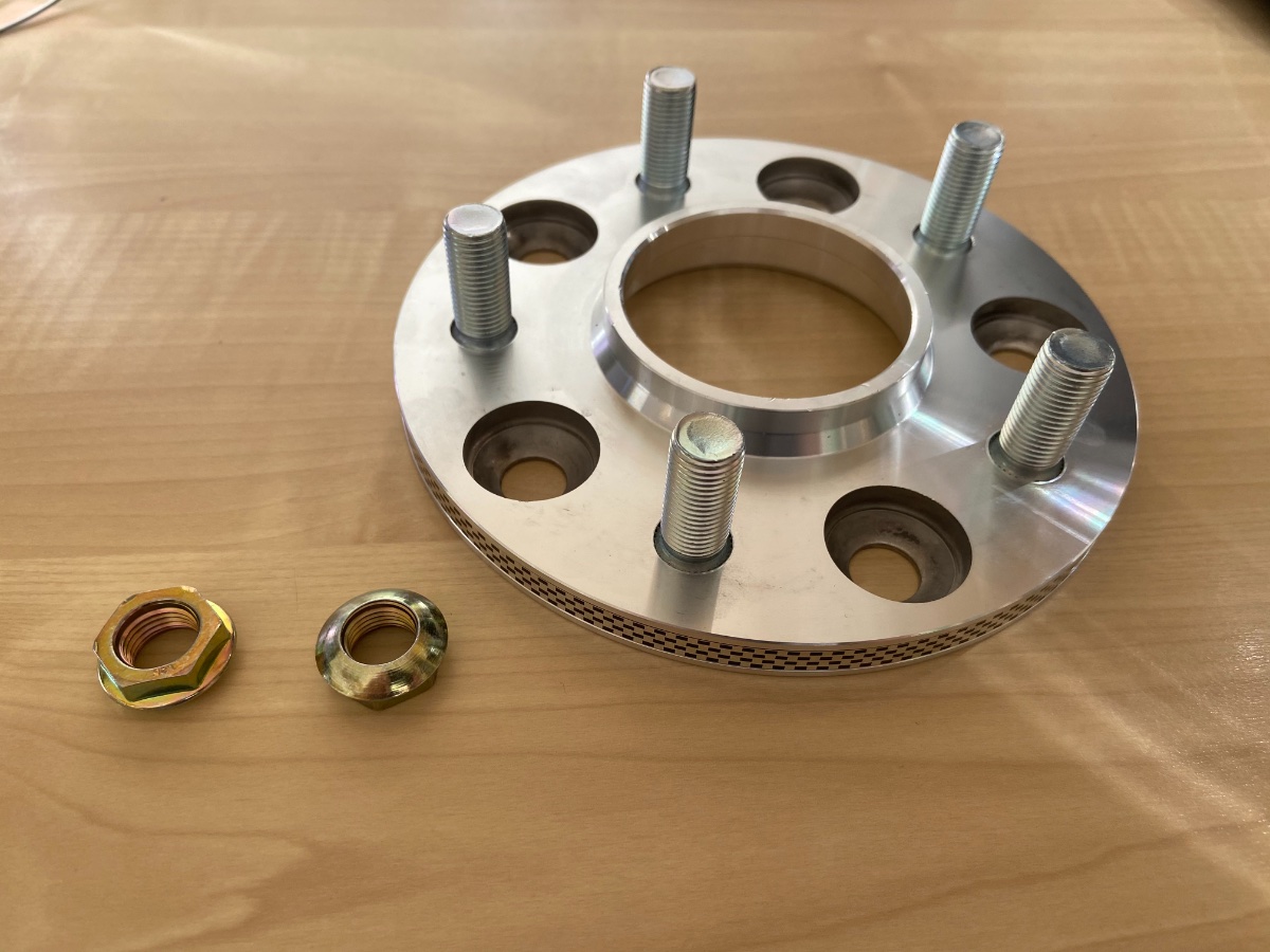

  3. Update - imported FIC Hubcentric Wheel Spacers, Pair 10mm 5x114.3 12x1.25mm, Part Number: WP5110-66N from Concept Z Performance and thay would appear to have solved the problem. Many thanks again for the advice
  4. Did you fit the spacers front and back

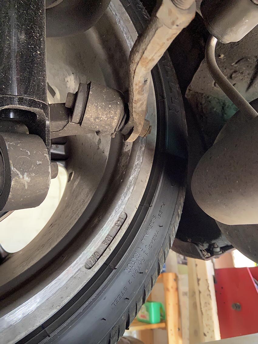

  5. Yes the car has an altitude issue - has an one ground the bulbous end of the hicas arm
  6. Between showers got the wheels of - marking on inner rim 10Jx18J H2 ET 45 which I assume is +45mm offset. As I am having alot of trouble with ride height I increased coil overs 14mm all round. Did not solve HICAS hitting the rim but noise has changed a little !
  7. Yes identical scoring (haven't checked offset markings on inside of rim because of the rain !
  8. Offset I need to measure

  10. 265/35 ZR 18 (93Y) N4 - but no issues before coil overs fitted

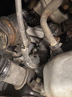

  11. The electrical sleeve to the gearbox speed sensor (1991 auto) has split and one wire is severed, everything seems to be working except the HICAS light is on. Has anyone come across this before. I will not have a chance to repair and see what happens for a few weeks but am curious.
