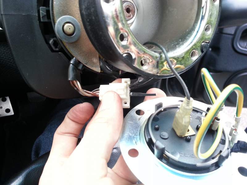

  1. that certainly looks like the connector and the whole part looks simliar to what is behind the boss. I didnt end up taking the boss off today, just the steering wheel as was running out of time. Would I be right in thinking this is not a hicas compatible boss?
  2. right so i managed to take the dash apart today. The hicas light was disconnected (and up in top right :D) so now ive hoked it back up. Without hicas fuse in the light is on, with fuse in it doesnt come straight on but when driving it like this before the back end was a bit skitty so havent taken it for a drive with it in and the light connected yet. Tried to put the car into the hicas diagnostic several times, obviously with the fuse in, but I cant seem to get it done. Thought i would then check the boss but is there any way to tell by looking at it whether it is hicas compatible? I have attached this pic because the horn also does not work but there seems to be an extra connection with nothing attached. Any help much appreciated
