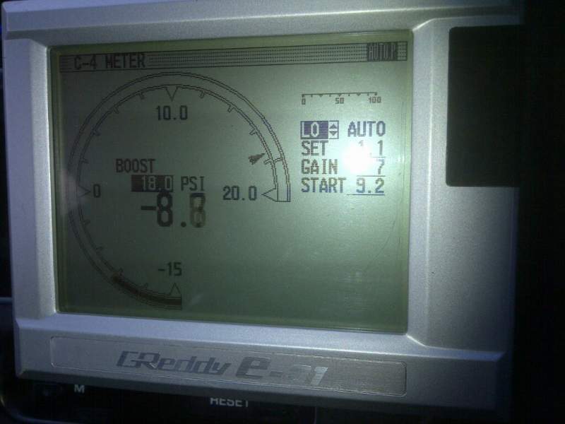

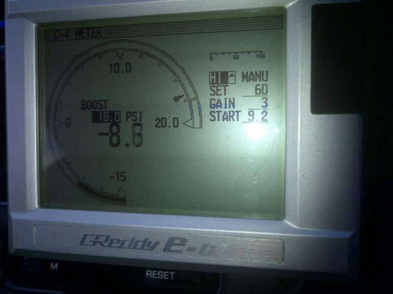

  7. Hi all, Appreciate any advice you could give me for my Greddy E-01. Haven't really made use of it so far as I'm not sure where to fix the settings. As far as I am aware, my fuel injectors are stock. I want the settings to make a noticeable difference but obviously don't want to damage my car! Here are my current settings: HI LO Thanks in advance, elymac23

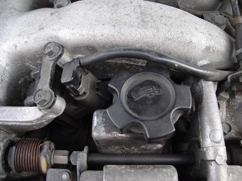

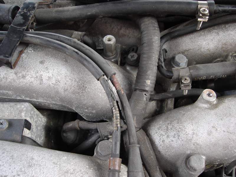

  12. Hi all, I'm waiting to hear back from Jeff on this problem, but I would appreciate any advice you could give me from your own personal experiences, etc. I have an engine misfire caused by a cylinder not firing. I've isolated which cylinder has the issue by having the engine tick over and unplugging one coil pack at a time. When this coil pack is unplugged there is no difference in engine speed. We also noticed that jiggling the harness holding all of the cables at various points altered the engine speed. This suggests to me there is cable damage and connection problems. Not sure it's advisable driving from Portsmouth to Zedworld like this! I know a very good auto electrician locally who has told me he has worked on Zeds before. You know how it is though, I'm not sure he would have the knowledge or spares to resolve the problem. What do you guys think? Please excuse my ignorance, I'm learning as I go. Thanks in advance, elymac23
