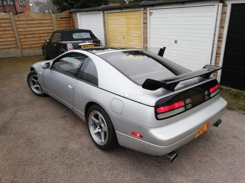

Hi all, I bought a manual TT that had recently had an engine rebuild but still had some problems. I took a chance on it... this is generally my preferred approach, it's more fun... kind of. When I picked up the car, I discovered that it smokes on overrun; decent plumes after engine braking at low speeds, then when the throttle is reapplied or if the engine settles at idle (typically when pulling up to a junction or slowing and accelerating between speed humps). No smoke when accelerating or at start up / idle. I have been doing a lot of googling and reading a lot of old forum threads about these symptoms, but none of them finished with a conclusive result. I will make sure that this thread has a conclusion even if it takes a while to figure out. Advertised spec: Engine rebuilt by Outlaw Customs Wiseco forged pistons Eagle rods AEM series 1 ecu 615cc Nismo injectors NA rear diff and hicas deleted Rebuilt turbos Stainless steel custom exhaust with H pipe and Greddy back boxes HKS blow off valves Currently running 380hp, mapped by DWR Performance Culprit #1 - PCV I noticed that the car had too much oil in it, and thought that maybe the PCV pipes are pulling oil up into the intake plenum during vacuum, which would then get burned off as the engine idled or accelerated. I looked into the balance tube holes and there is oil in the plenum. I then did an oil change and deleted the PCVs for good measure (into a catch can), the pipes were full of oil! I also swapped the spark plugs from Iridium BKR7EIX (which sit too far in the head) to NGK PFR6B11C gapped to 0.035. I have only driven the car around five miles since, at first it seemed much better but the smoke problem returned. Perhaps I need to drive it a bit more. Should I also reroute the breathers at the front of the engine? My next potential culprits are: Culprit #2 - turbo seals Culprit #3 - valve seals Culprit #4 - piston rings ... anyone want to add to the list of possible culprits? Cheers.
