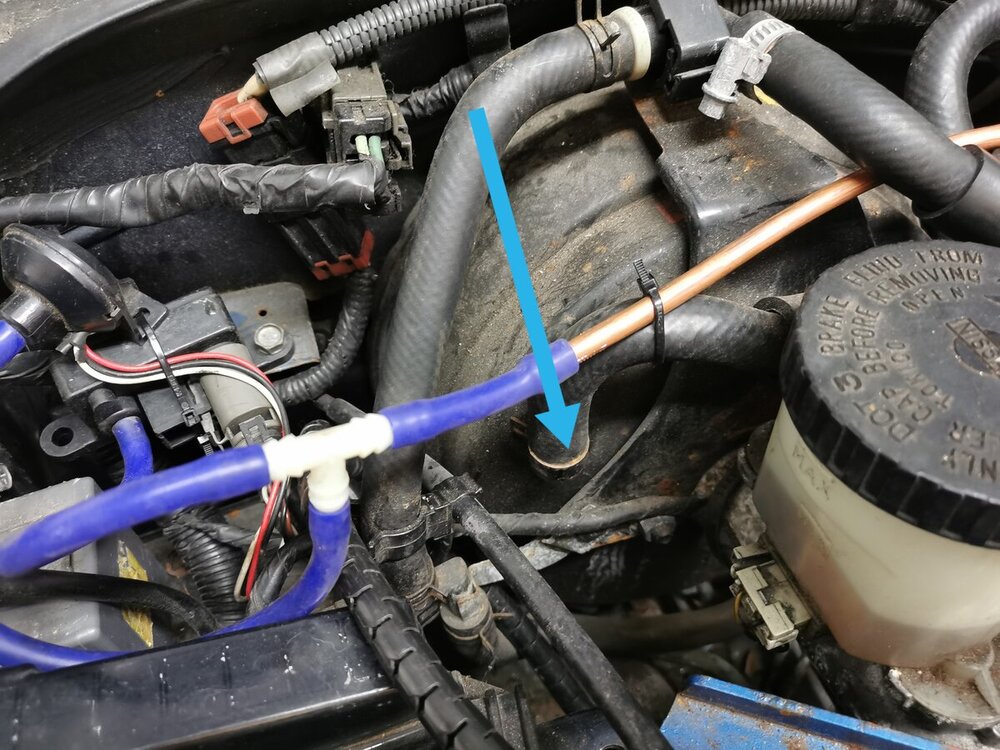

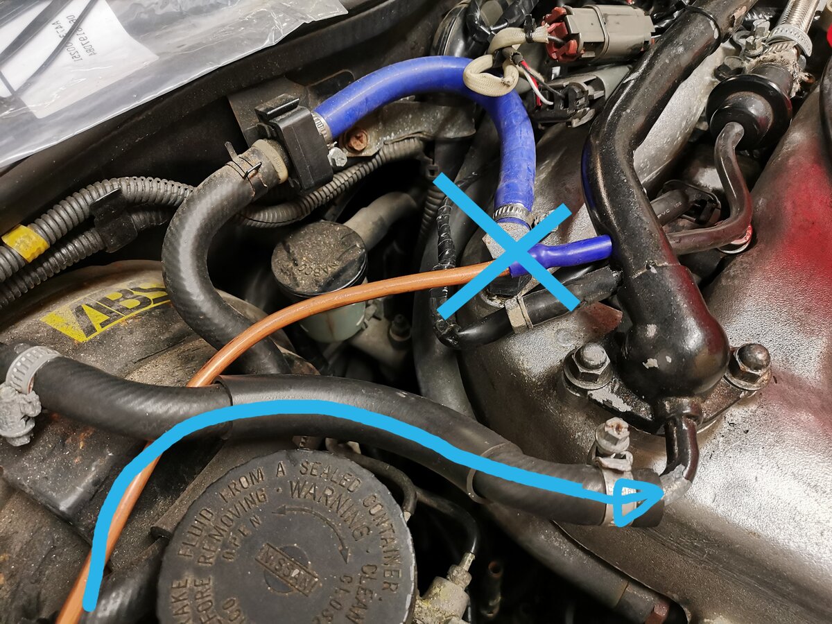

  1. Well the 15 years of engineering progress could account for that. But pretty sure my e30 didn't have it either. Il remove what looks like a good chunk of it I think and see how it goes. Still other bits to fix before it goes near a road yet. Cheers all
  2. Running without the vacuum tank sounds like the option for me then. Was it there just to aid clutch feel after the car is switched off like a brake servo does? I have no clutch assist in my bmw. Thst doesn't seem bad atall. How comes the zed clutch is so much more harsh?
  3. Evening. If I am removing the clutch booster and all the pipework can I route this pipe from the balance bar through the valve to the servo? Then remove all the rest and blank off the blue x in the plenum? Is there any other pipework to this stuff or electrical connection I need to watch out for? And finally I'm doing all of this to remove as much old pipework as I can to minimise leaks. But is it even worth it. Does the clutch feel much different? I've not driven it in so long I won't even know the difference if it does now. Thanks

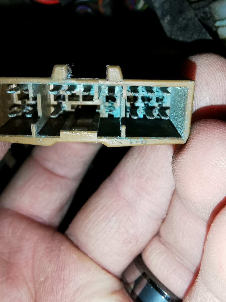

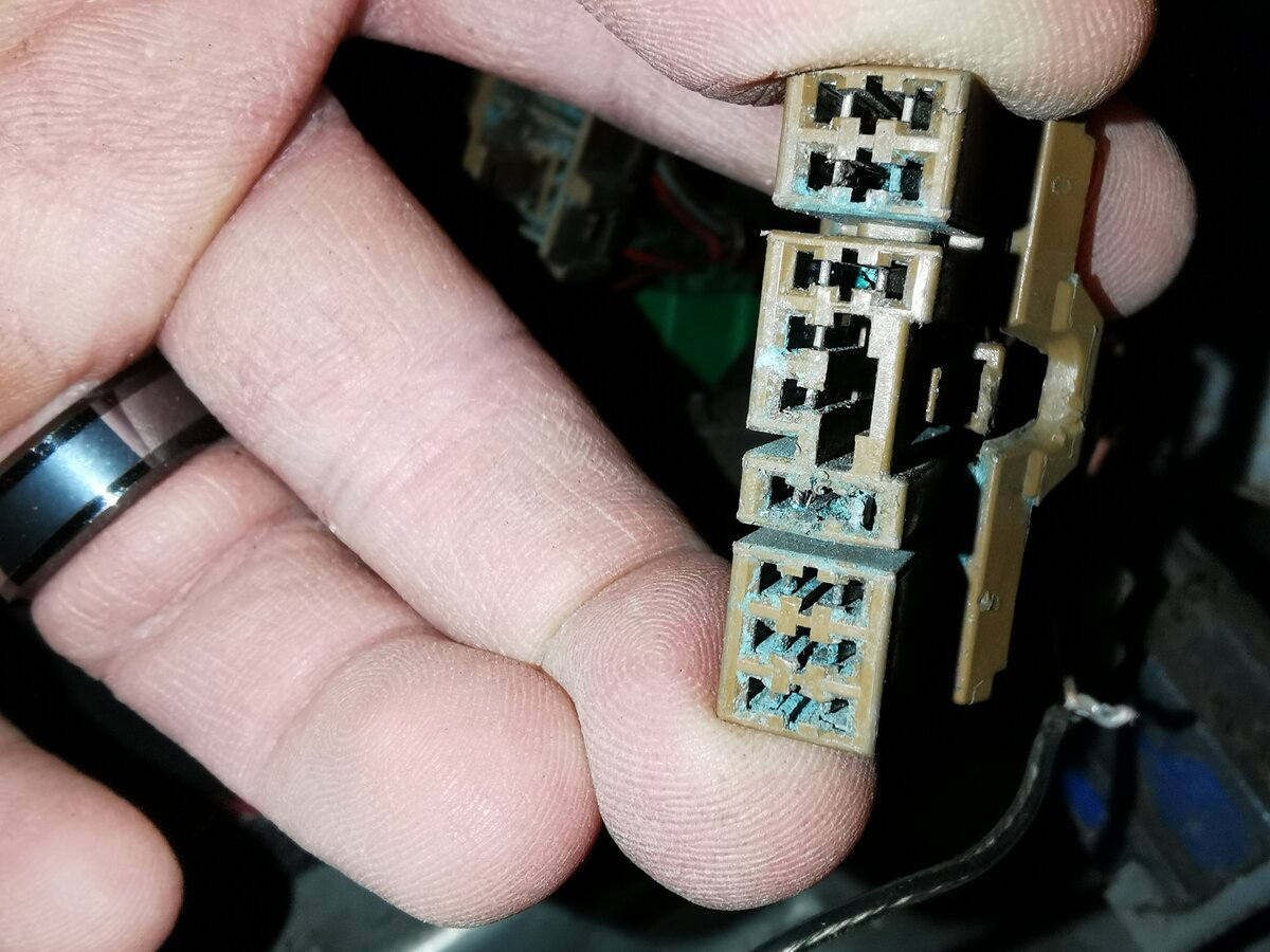

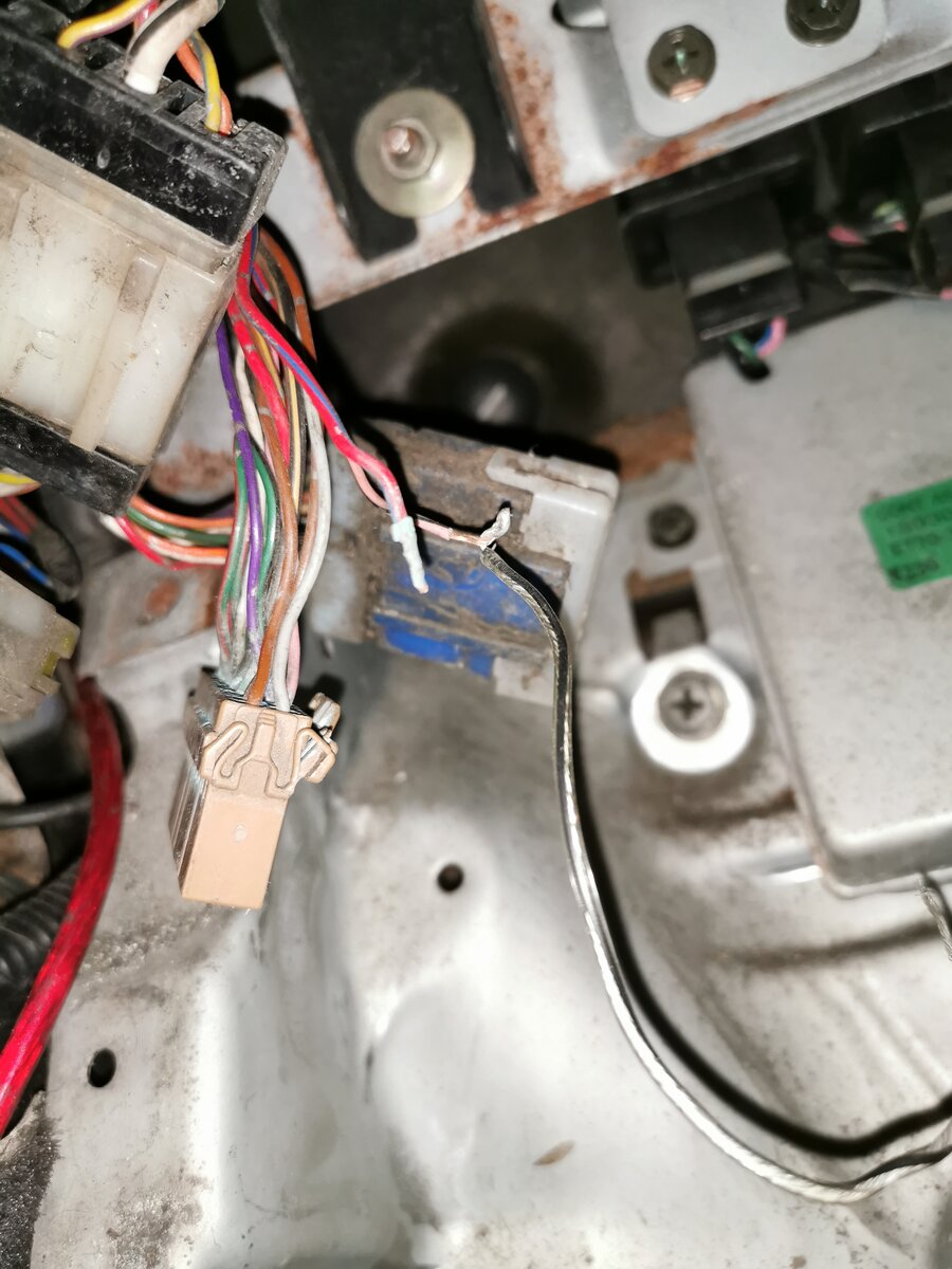

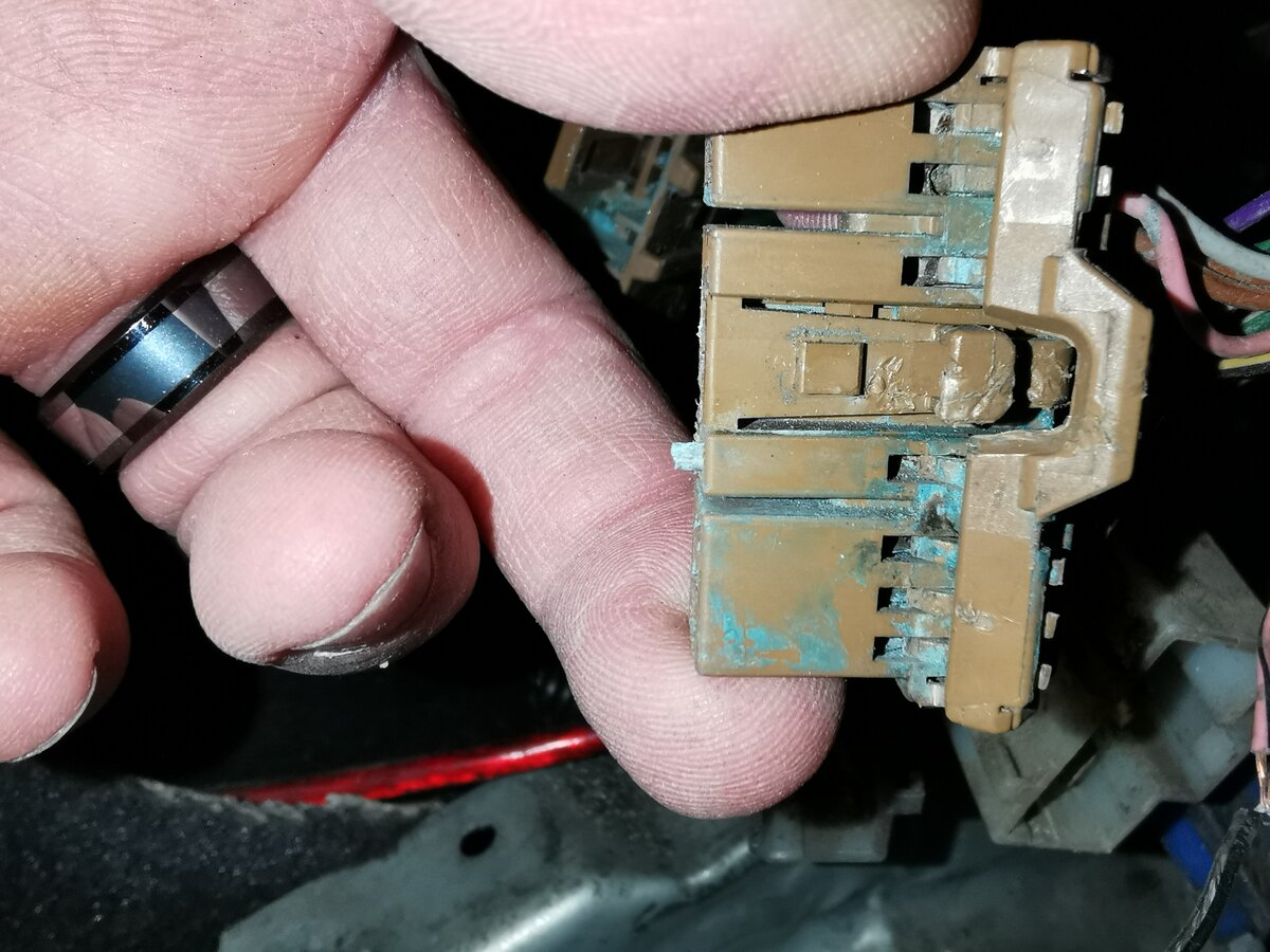

  4. Subbed as you all need to see this. Might be out of correct order. But this is what I saw. I have cut the plug out and hard connected all the wiring. It all works now. So happy! This has stumped me for years. Thanks all. Onto the next issue. Feels good to be working in the zed again I'll start a new thread.

  6. Im back on this after renewing most of the connectors on the efi loom. Now I have another issue. But I think it's probably a vac leak. It idles for about 10 secs. Then revs drop lower and lower and stall. I've wound the icv out but that's for another day. This connector pretty much fell apart as I got it all accessible. Pins fell out. Connections fell out. But. After bypassing temporarily, I still couldn't get the results I wanted. I can get main beams to work if I earth the purple blue wire. But thats obviously not correct. How do I get pics on here?
  7. Might have to bypass the whole plug. It's all a bit manky and brittle. I have to dig underneath to see if it is the loom I think it is.
  8. Thanks Chris I have some pictures of that "green" plug, I cant see how to upload on here. So I need to be a subscribed member? It is indeed knackered on that plug and 1 wire was broken out. Looks like it had already been repaired with a bit of speaker cable, that had also broken. I stuck a pin in it and tried to see if I had anything. But guesse what. Dead battery. And the battery charger just gave up aswell. So this will be on hold for a while. Ill concentrate on the engine harness, currently taking out unused plugs and I will be putting in new injector and coil plugs, aswell as relocating the ptu somewhere out of sight. Theres a lot of cables im not sure about. 1 being the one hanging from under the relay box to the underside of the car. Ive not got it in the air to look yet, but looks like my issue bundle of wires. Thanks all

  13. Hi all, been a while. Finally getting a chance to look over the Zed again. Aswell as the brake system needing looking at (at least 1 burst pipe) I have no headlights! Car is a UK 2+2 PFA of the one of the last times I drove it. a few years ago now. I could do with some advice or a steer in the right direction. At some point someone has fitted HID's to the car and done what looks like the earth mod so the flashers don't turn off the headlights. About 2 years ago I had 1 headlight randomly stop working, bulb was fine so I just fed a wire from the working one to the other and that worked for a year or so. Now I have none. The dash switch turns on the sidelights, no flashers, and no headlights. All the bulbs are fine as I have jumped the relays to get various combinations working. First step was looking at this thread But my relays are different to these to start with. I have a twin switch brown relay under headlamp LH position. and a black one under headlamp RH position. I understand they are supposed to turn on the headlamps dim with the sidelights on but that doesn't work either. Ill get a picture in a bit to show you all how it looks. Any help would be massively appreciated as id like to drive this car this year and no headlights = no mot. Cheers
