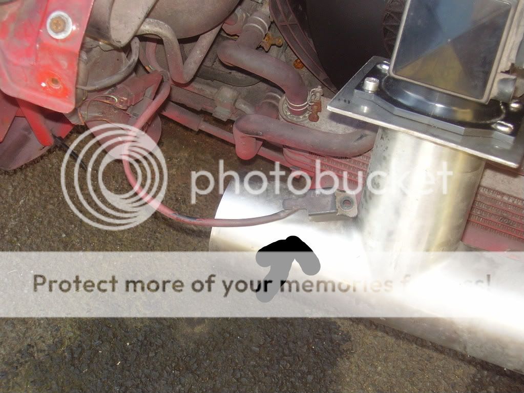

  2. yes your maf is fine, and you should have two dump valves which is no doubt the problem your getting.
    Either get another fump valve with hard pipe and install it on the other side (expensive) or locate some standard recirc valves which are located under the maf either side of the electric fan (probably still installed) and reconnect them removing the dump valve on your car
