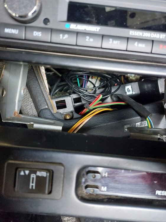

  10. Ting into both sides seems wise, thanks for the confirmation

  12. Guess I'll just leave the switch and box in place for somebody else to scratch there head over down the line. I'll keep hunting for the aftermarket alarm box now. Thanks
