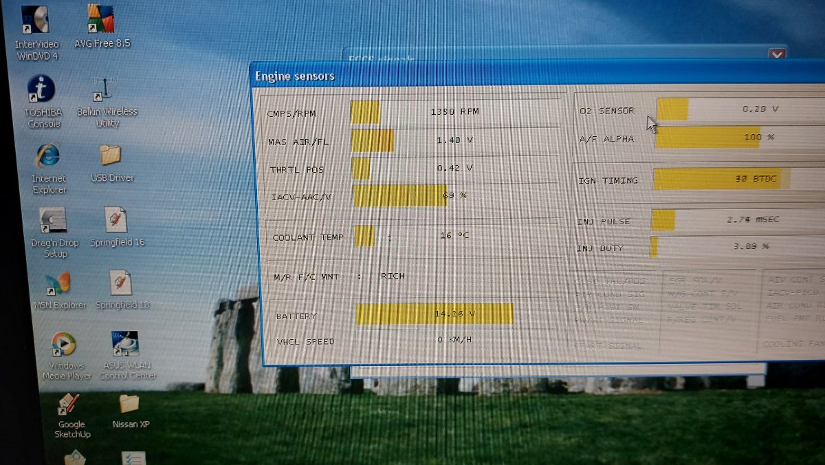

After timing belt and head gasket done the car will not run, starts easy but fades out over about a minute, very little throttle response. There is a timing issue, on full cas adjustment can only get 30'btdc. Fuel pressure good, tps set ok, spark ok on all, compression is ok but not great, hopefully improve once run in. Injectors seem to be firing ok. Conzult suggests it's rich and shows the timing out but no other faults. Im confident the timing belt is installed correctly. Not sure where to look next so any ideas would be appreciated.

As already mentioned it wont be able to set the timing properly until the engine has warmed up, you can idle at 30 degrees so find out why its dying out and go from there

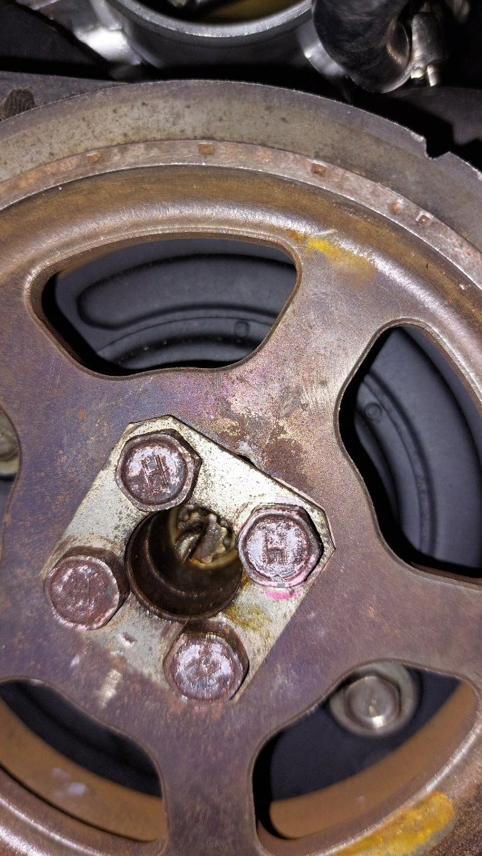

So look you either have 2 faulty CAS units or your pin is messed up. When you insert the sensor in the D shaped pin on the end is just to guide it onto the actual spline, Try pulling it a few MM keeping the sensor on the alignment pin but not actually on the splines, then attempt to relocate it on another pin.
To check if the pin has rotated inside the camshaft - The flat part of CAS drive pin in the exhaust cam should be inline with the center of the dowel pin, with the D section being on the left side when looking at it from the front of the engine.

I did refurb the injectors and rail so possible somethings gone wrong  I'll go there next. There is play as you insert the cas, not sure if it's enough for a full notch but will find out when it goes back together, D seems aligned, not many other options.
