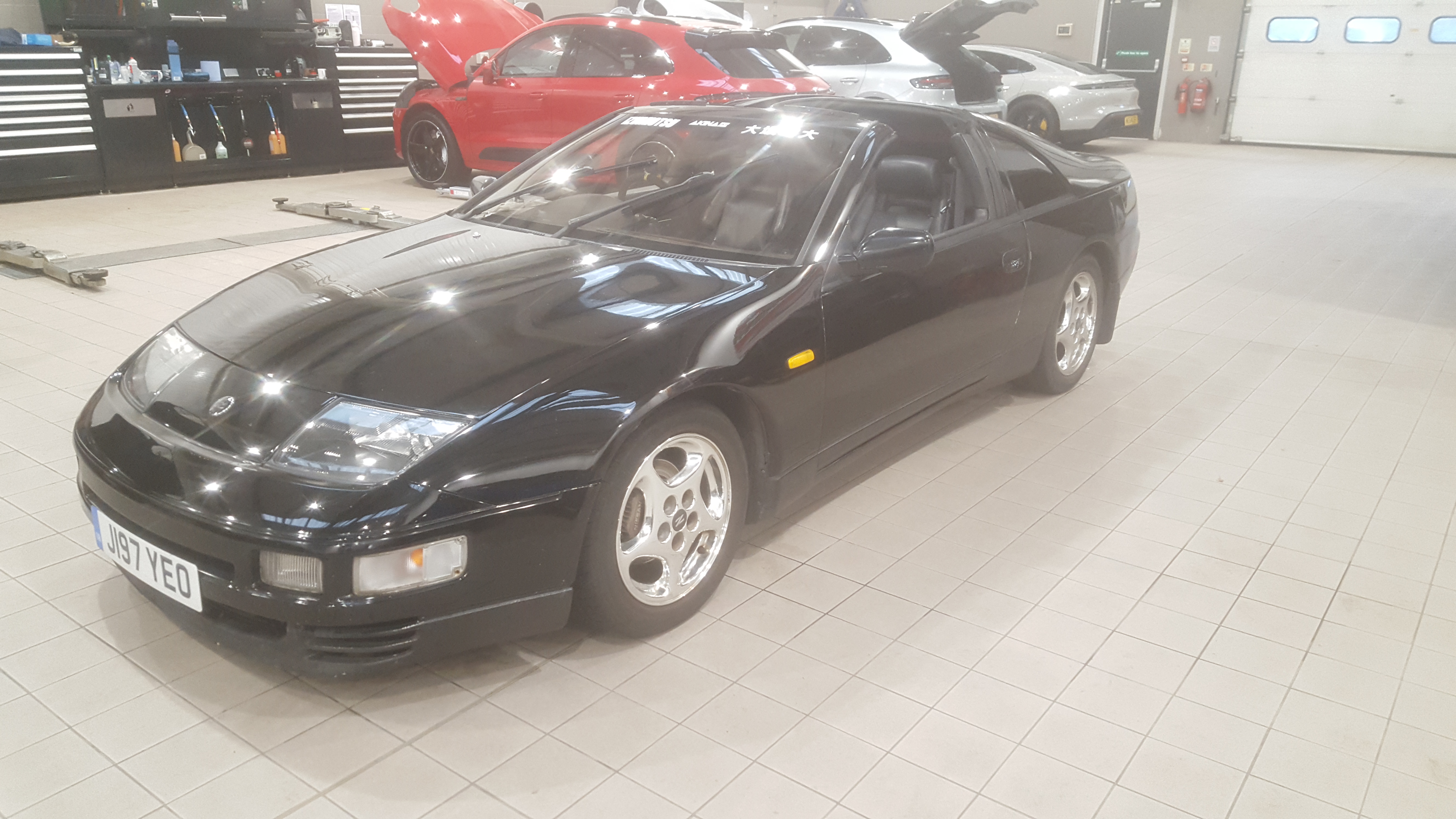

  4. Hi all, thought I'd throw on some progress Ive been making on my 92 NA 2+2 since I got it. I aquired the car mid Max Power transformation as per my newbies thread (first time z32 owner) and set about returning to a nice factory example. Mechanically the car is very good, runs nicely, pulls hard and after a good service has given peace of mind to use through the spring. I take the Z to work at least once a week plus weekend fun just to keep it alive. I'll be using the car in its current state throughout summer before tucking away for winter for a full body and paint restoration at my friends bodyshop (although Ill be doing the work myself, many late nights after work to come!!) Since Jan 21 Ive been hellbent on returning the interior to stock as it was really embarrassing... fur interior panels, wrecked leather seats, drift wheel, dodgy accessories and a crap head unit to name but a few! First thing I got was an OEM steering wheel in near mint condition. Had trouble acquiring the slip ring and gubbins behind it bit was eventually rescued by Keith (North Wales) who supplied all the neccessary items... fitted... excellent!! Tried the horn.. worked for about 3 seconds, then died! So they're now on the shopping list. Other interior items sourced... 2 from Andy (OEM shift knob, original factory head unit), factory CD player, new dash fascia, leather with red stitched shift/handbrake boots and various other trim bits. Beginning to take shape! Now to tackle the fur (on ebay at time of typing fyi). Through multiple sources and sellers I managed to acquire a full set of tweed panels for the interior. A lot of the parts must have been stored in parts cars and had various bad stains from dirt/oil etc. The missus now steps in with a variety of Dr Beckerman cleaners and brushes etc.. the next day every tween item looks brand spanking new!!!! She insisted! Now all the fur is gone, the leather seats are letting it down. Having a conversation with Keith again he mentions he has a full tweed cloth interior in excellent condition so had to go for it! During the install of the seats I found 9.80 in change in the rails... and a 10 Japanese Yen coin (like.. negative 30p?) Most recent purchase after some Targa bags (Keith again, lifesaver!) is an OEM set of shagpile mats... cant wait for these to arrive! Got them for a very good price too :-) So here I am, interior is pretty much nearly done, bodywork is still shot outside (bad dents, couple of bubbles, microblistered paint, scrapes etc and a wrecked turbo front bumper. I got the original NA bumper from Andy however still yet to paint/fit this. Oh.. and the speedo/odo still not working. We've tested the speed sensor in the gearbox and it has continuity and all seems well. Next area to investigate will be behind the clocks. All in all Im absolutely in love with my Z, such a nice experience, had the T tops off the other day and we had a blast! Once the bodywork is sorted, this cherished example will be a shift return to its former glory days and will be lived for many more years. Please see attached pics of the interior then and now, and some exterior shots. Happy Zedding all Sent from my SM-G925F using Tapatalk

  13. Very helpful Andrew, thank you! I do like the way the TT bumper looks on the car to be honest, and I think Id like to source another one of those, that is if mine cannot be repaired. The 'posts' at the sides of the bottom vents have collapsed from the top half of the bumper if you get what mean? So the bottom section sits low to the ground. The car has also previously been lowered so I really have to be careful which angle to take over bumps etc as it scrapes. Ive been in touch with the guy breaking the silver NA who hopefully has a slip ring for me. He works offshore and returns this week so he'll check then ? And brilliant, Ill check the wiring on the sensor and see whats what when it has the servicing work done. Someone has been in the clocks before. The 'K' from the kmp/h has been blacked out as if altered previously. Ill update you when I have more info. Thanks again!! ?
