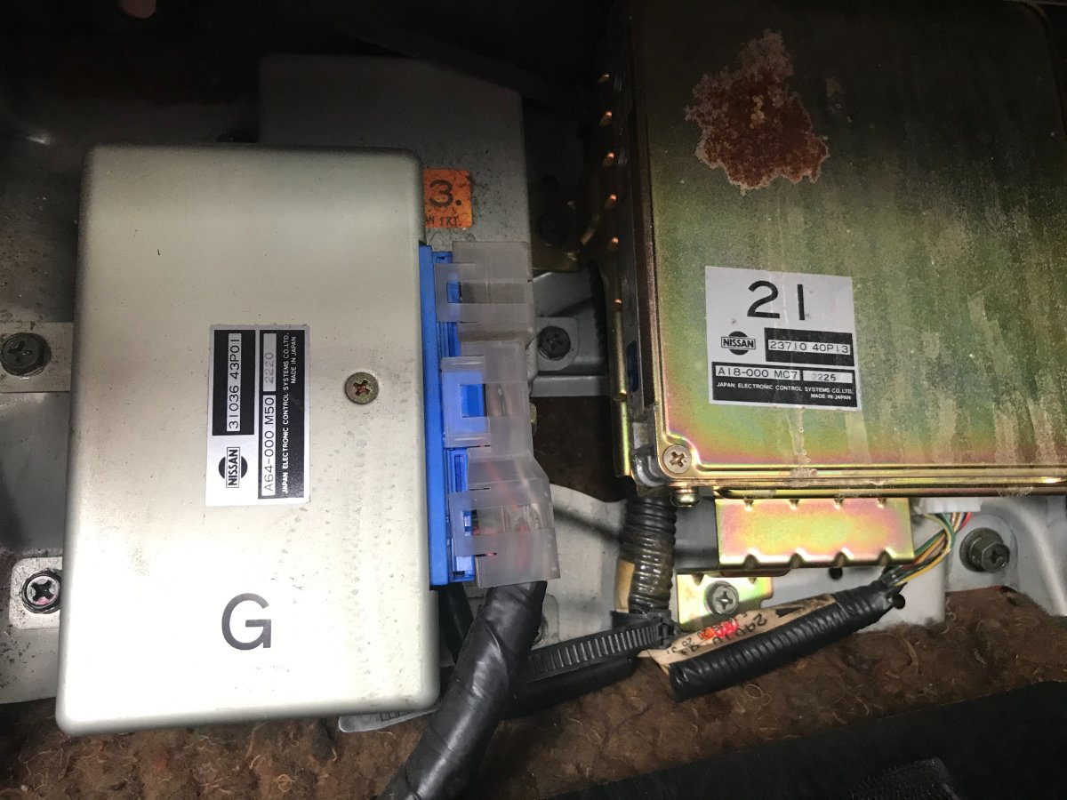

  11. Thank you andrew, It was the MAF for the most part, now the car runs pretty good, went for a solid drive but my fan is always on; and is taking a long time to get up to temperature. Running a little rich but not as rich as it used to be with the wobbly MAF. I tested both of my Coolant temp sensors dipping it in 68F, 122F 176F both produced In-Spec resistances, the plug is getting a good constant 5vols, and the ground is found on the other pin. the relay is giving me 0.70 resistance like 3 other relays ive tested but im unable to test right now if it clicks. is there anything else i can test in the mean-time regarding the Engine fan being always on when the engine is running. Also i dont know if this is a new issue but tonight i noticed that whenever i flip my day-time running lights/turn the dash liights on or use low beams all of my warning lights turn on allong with 2 of my break lights (excluting 3rd center light) I hope i havent messed up a relay or something pulling a few out during my tests.
  12. oh dayum, well since the ECU panel was off i thought ill ty turning the screw on the ECU, and it gave me code 12, and i shit you not when i jumped the connector under the steering wheel it gave me 55 like a week ago, but it was running quite allot better back then... should i bother testing or just replace it, or what kind of tests do you think i should do?>
  13. the trouble is, im not getting a "check engine light" or anything, ill see if i can reset the system, i had it running really well yesterday, before i started messing (swapping) the coolant temp sensors but the fan was still on. I just want it to at least hold a steady idle so i can diagnose more. Before i start ripping out the ECU i also want to make sure everything else is working for certain, like the o2 sensors, ohm the Temp sensors ect. Thanks for your insight AndrewG!
