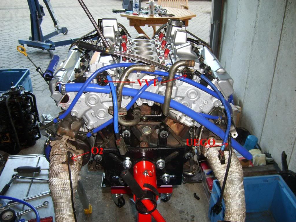

oh by the way when i was looking for the bleed valve i noticed that the wire from the lambar sensor was not connected to anything and i couldnt see anywhere with in reach of the wire for it to plug into any ideas?
one of the problems i found with these cars is that you dont know the history of them before they come into the country, so anything could have been done to it. you may well have a series one with enough series two bits on it to fool the majority. or it could be a series two where some muppet put series one parts on it. god only knows lol :D
lol i will have to wait untill its 100% and i can come along to a meet where you guys can have a look at it in person
they usually disconnect them when they are faulty, the engine will run but will give symptoms like what you have described. basicly its not reading the exhaust gasses to determine the quantities of burnt fuel and air mix, so as i believe it will dump more fuel in to eliminate detination
ahhh so that could be the reason for all the problems do you no where i can plug it in ?
there should be a plug floating around some where, dont mistake it for your VVT solenoid or waste gate solenoid plugs. there are only three plugs down that side of the engine so just have a route around. this pic shows the VVT solenoid and O2 sensors but not the wastegate solenoid (not used). it should give you a rough idear.....
