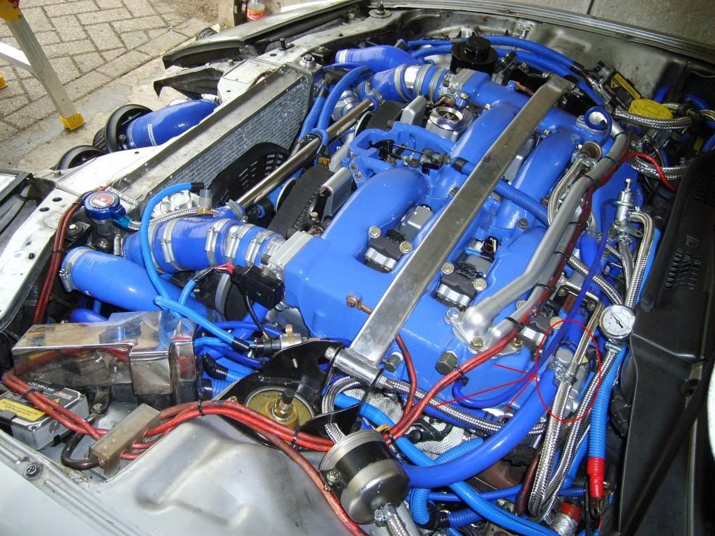

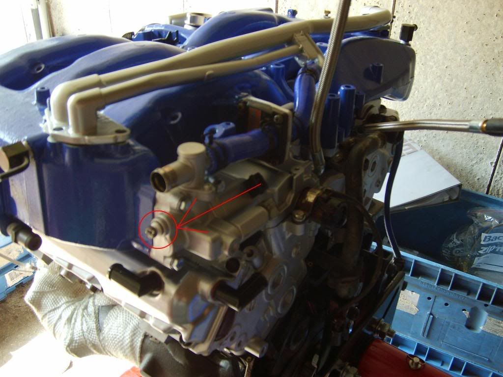

a couple of pictures of the valve in question, that should be the last thing to adjust after you have checked every thing else i,e... TPS, timing and once the TB's have been cleaned and sync'd. the valve screw is a pain to get to as the battery is in the way. use a long thin screw driver to adjust it and make sure the top yellow connecter is disconnected.
ive circled the valve in red for ya;)
HTH
thats a really nice looking engine.lol. Impressed mate.
wow that motor looks fantastic..must of been a pain in the ass to replace all them pipes too:bow::bow:

lmao pain in the arse would be one way of putting, ive still got a hugh box full of silcone and SS pipes all shapes and sizes left over lol

hi lads, do you screw the idle control valve clockwise for more fuel to make it idle faster or anti clockwise, i imagine anti clock wise but just wani check?
counterclockwise to increase idle, clockwise to reduce idle. Cheers:D!
