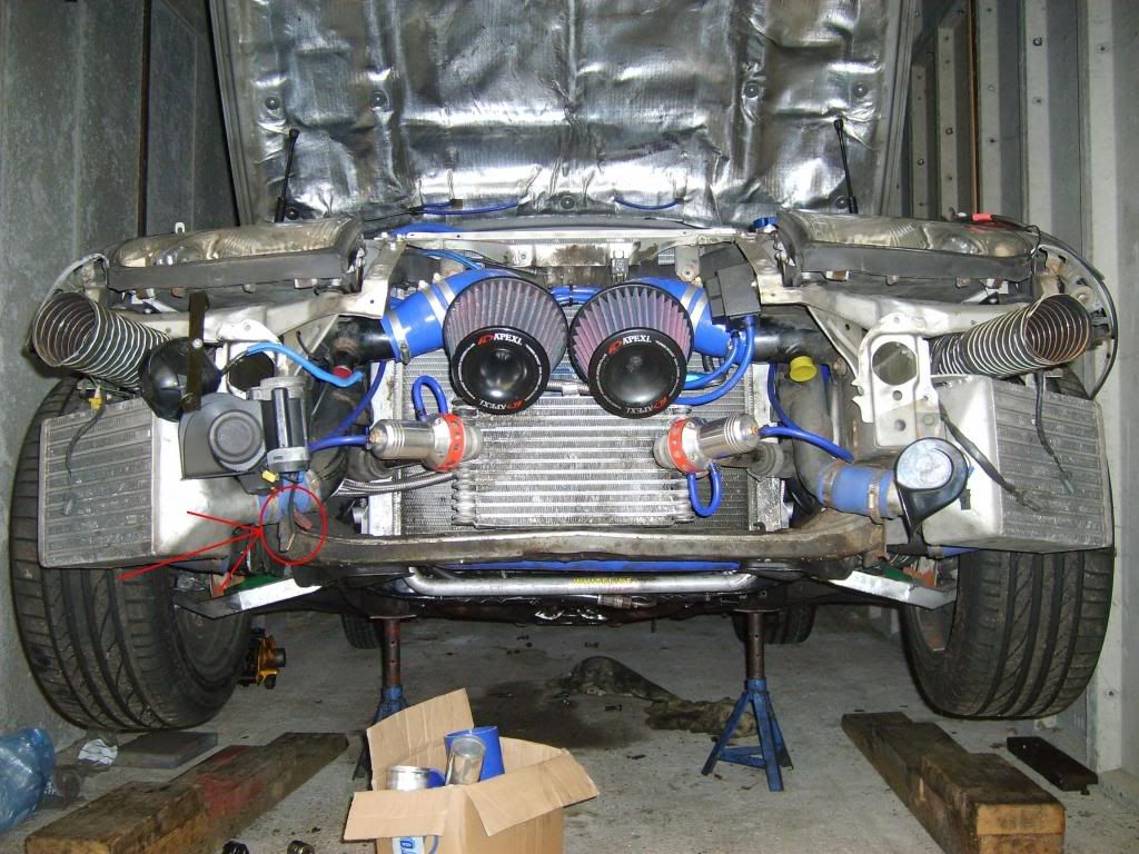

it should be bolted to the inside of the bumper, with its wire running off onto the same loom thats connected to/near the condensor bottle. you can see the wiring circled in this pic
HTH
Thanks Silverbullet. I did have a look at my old bumper but didn't see the sensor. I'll look again and also ask the mechanic who changed the bumper out.
In your picture is it the red connector that would connect to the sensor?
I presume I can get a new one loose from Nissan and fit it to my new bumper?
Oh, well, the sensor isn't on the bumper. Could it have been bolted onto the elongate black bumber support (which I no longer have)?
off the top of my head, i cant remember which one it is. possible its the grey one. have a word with Paul@SWZ, im sure he'll have a dozen floating around. will be a hell of alot cheaper than Nissan
not sure where on the bumper its bolted to, never owned a stock one lol. its a little black/grey box roughly 1-2 inchs long with a bolt hole at one end
