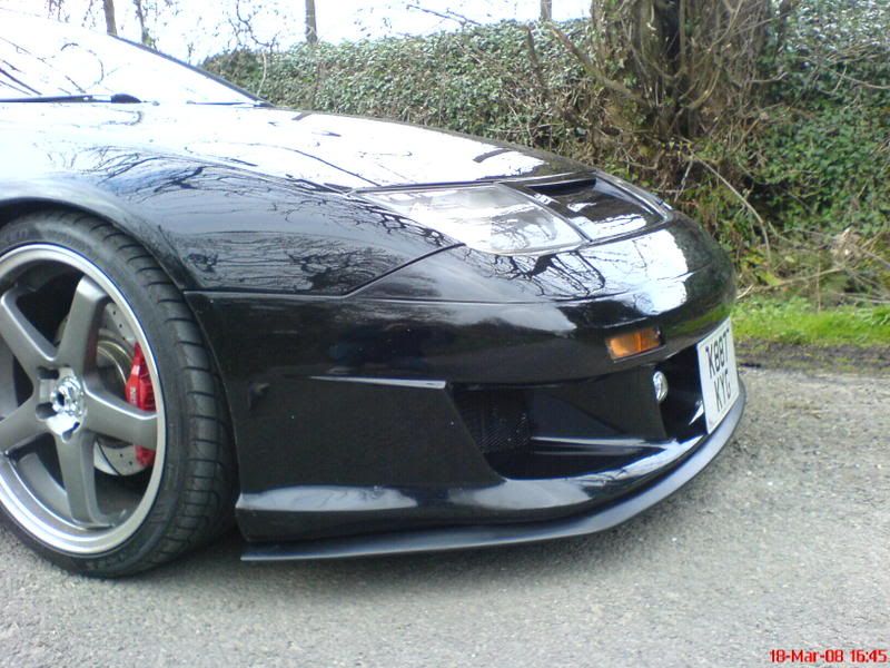

This is the best close up i have. you cannot really tell. But if you wanted i cannot see why you couldnt drill them through but you would need some good drill bits. They are also EBC discs
They do look good, what size wheels are they?

Those are the m3 discs 315mm with 19" wheels. I do have a pic with 18" on if you want to see them? you might of already.

I had the 18" volks and they were a bit tight. Need to find out the with of the m3 discs as the kit is made for them not the zx ones
18"s all shiny and new :)
