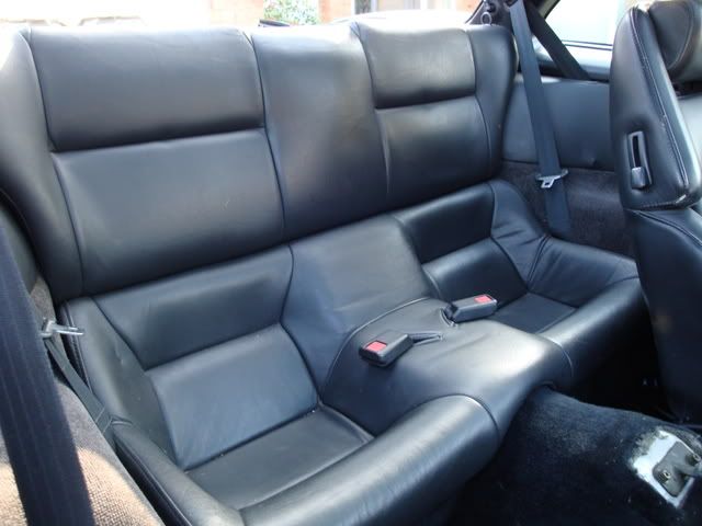

Beermonster, here is a pic of the rear seats, I have not taken them out yet, would want about £50 for them, I see you are in Notts, not far to come and collect them.
If you want to email me about it my address is 'alexcatlow at hotmail.com'

those back seats are in great nick - i dont reckon they've ever been sat in :)
