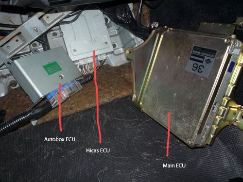

Behind the passenger kick panel, I have 3 boxes. I would like to know if I have labelled the pic correctly? If not what is correct.
One other thing is that my car has had a manual conversion and I believe that my Hicas is disengaged. Could I disconnect both the autobox and hicas boxes? Or does the hicas work the power steering as well?

I think the Cruise ECU should be in there, it is on my 92 Jap Auto TT. My HICAS ECU is under the dash on the drivers side - off side
The PAS and Hicas ECU are shared. You need to keep it connected....and yes you have it labelled correctly. You can disconnect and remove the Autobox ecu though.
Thats not your Hicas ECU. Its in the Passenger footwell. The only ECU I can think of in the Drivers footwell is the Climate control ECU.
