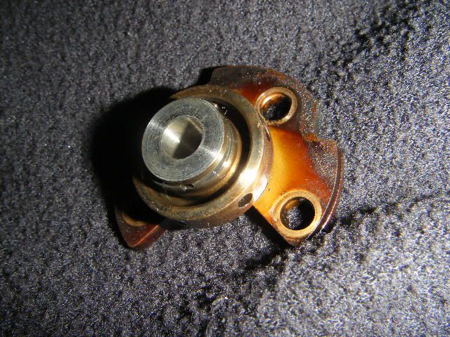

Thrust bearing looking a bit scorched, its well worn too

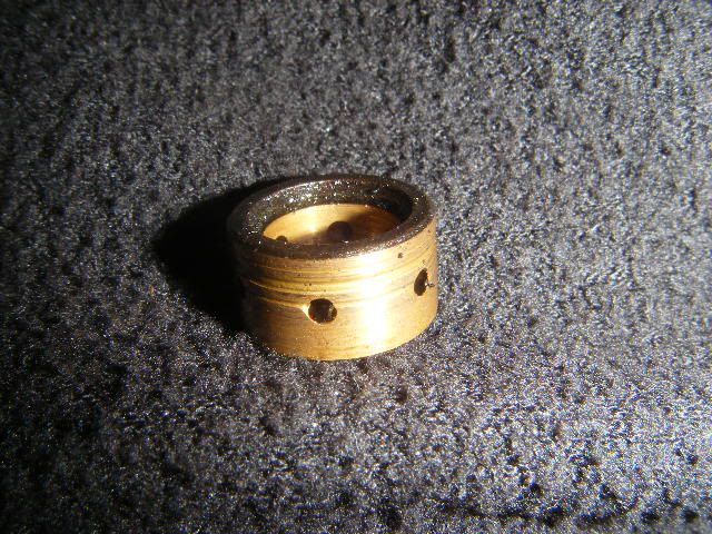

Zaust wheel end bearing scored
