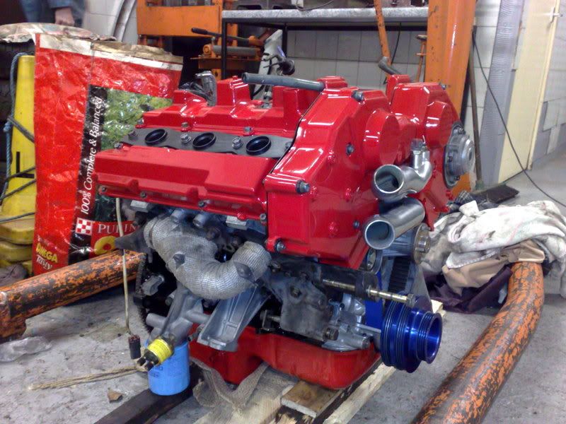

These are the only up to date pics i have of the engine since its been at the Garage. This is before I sent the rest of the parts I bought from Mario and Z1

I could well be wrong but it doesn't look like you have the iconel manifolds on the engine in the pictures, and yes if I was you I would just put a stock new thermostat back on!
Hi Topless your right they were my original ported manifolds in that pic;)
