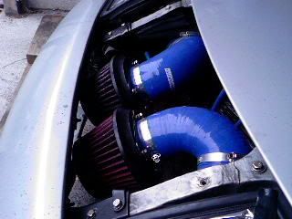

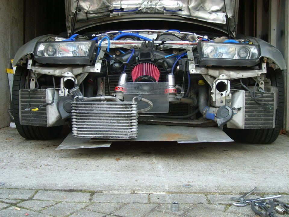

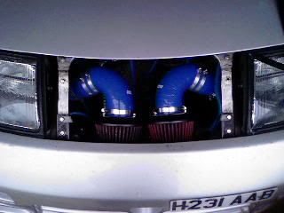

How did you plumb in the the different pipes did you have a reducer for the pipework somewhere?
theres a 2.5" to 3" reducer coming off the stock pipe. i did want 3" going from filter to turbo but there just isnt enough room under the head light with out fabrication, and i was'nt prepaired to start chopping bits away
