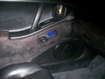

led door handle mod
For those of you who have ever had a passenger in your car at night and they can never find the bloody door handle
I used an smd led, which is flat, i dremelled out a hole in the plastic cowel for the led housing, ran a live feed through the door and through to the light pod, where i got a live from the lights feed and inserted a momentary push button switch to turn on.
I will do a write up soon as i think it will be quite a good mod for many.

Its only in the passenger door, cos i obviously know where the drivers one is lol, ive had a few passengers in the past that were scratching around for the door handle in the dark, which is why i decided to do it in the end.

Bloody good mod!!!
I like that because it's nice and subtle - less is more, less is more!!!
Do you mind if I copy it?

Hi Andy, not at all, everything i do on the car is for the good of the members, if they wish to make use of it.
Lets face it, you dont need my permission, its not like its patented or anything lol
