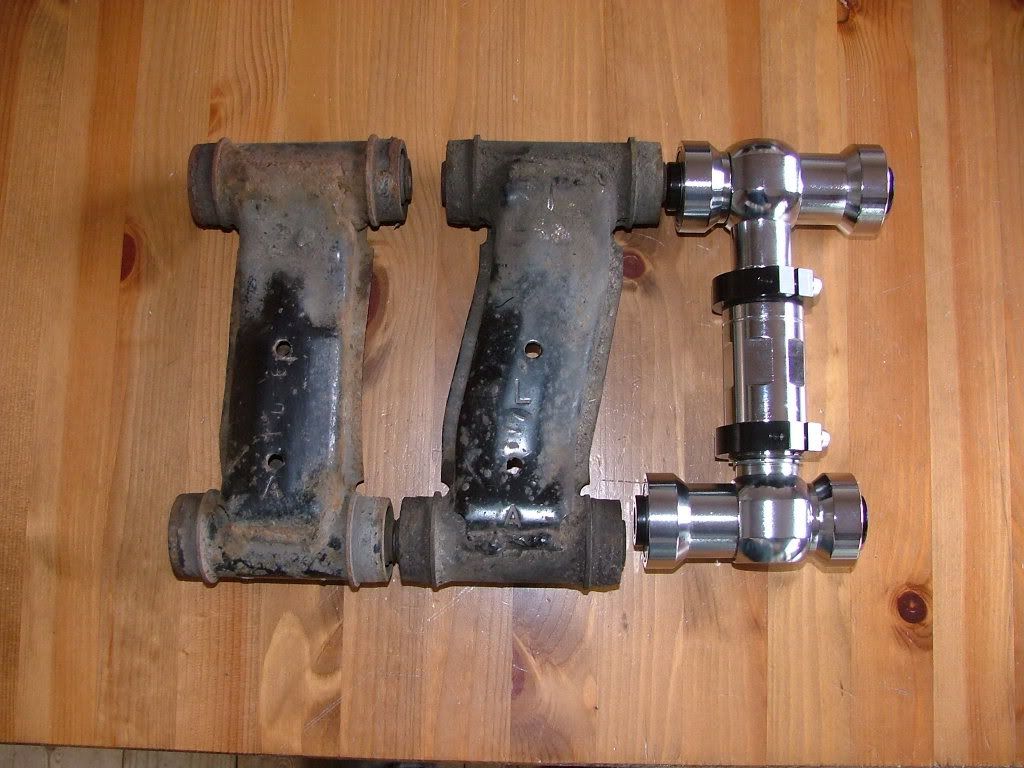

I'm in the process of upgrading my brakes and some of my front suspension on my 91 SWB N/A. When taking off the upper arms I noticed that both are (as the middle arm in the picture shows) cranked over. However I dug out a spare upper arm I had as part of some other 2nd hand stuff I bought and it was straight (Left arm in the picture). By twisting the Powertrix adjustable arm around it kind of lines up with the original arm (centre) but is this OK to use like this?

I just edited my post coz i wasnt 100% sure... My arms were straight like the left hand arm.
Am i correct in saying the middle one has been bent by hitting a kerb? or are NA top arms this shape? I have fitted adjustable and there were put on nice and straight.
The middle one IS bent and the adjustable should NOT be fitted like it is in the picture, twist the top part 180 and it'll be right.
But isnt it strange that both arms are bent like that?
And look at the L mark in the middle of the arm it looks like its straight?
But yeah they prob are bent.

I agree it looks like its been bent, however the arm on the other side is also bent in the same way and oddly marked R in the same way as the one in the picture is marked L. Also close up the arm does looked to have been manufactured in that way, no stress cracks, paint seems factory without chips or crazing and as you said j1mmytt the L is marked parallel to the A.

So if you try and fit the new arms with both sides parallel will they fit on your suspension correctly?
is it possible that your car had a front smash and bent both arms evenly or something... too be honest im baffled, get a pic of both bent arms and see if they are evenly bent?
Think I may have an explanation as to what they are or rather what they came off (thanks MrF). Seems that a lot of Nissans had this suspension set up, one of those being a Skyline and having done a quick search I have come up with this link pictures.
http://www.driftworks.com/catalog/products/r32z32-front-upper-camber-arms.html?products_id=
The top picture looks pretty like a Powertrix adjustable arm turned through 180 degrees like my picture above???
Given the above assumption is true, the original straight ones must have been replaced with these other bent ones at some point.
Does that mean my car would have less caster with these bent items? What would the benifit of that have been?

All I can say is that my upper arms were straight as well as far as I can remember.
Has the car been lowered and so perhaps these fitted to adjust the camber?

Yes the car is lowered so possibly?
I think my question is relatively answered now though, in as much as I can install the new arms in confidence that i'm not going to make the car drive worse than before and not be able to be put it back into spec on the adjusters.

Same as the R32 aren't they?
Never seen bent arms like that before but they are obviously meant to be like that - you could never bend them in that way by accident on both sides.
Changed mine recently and they were definately the straight variety that I removed.

ChrisC, Yes I believe it is the R32. Agreed, I'm bloody sure they certainly are made that way!
