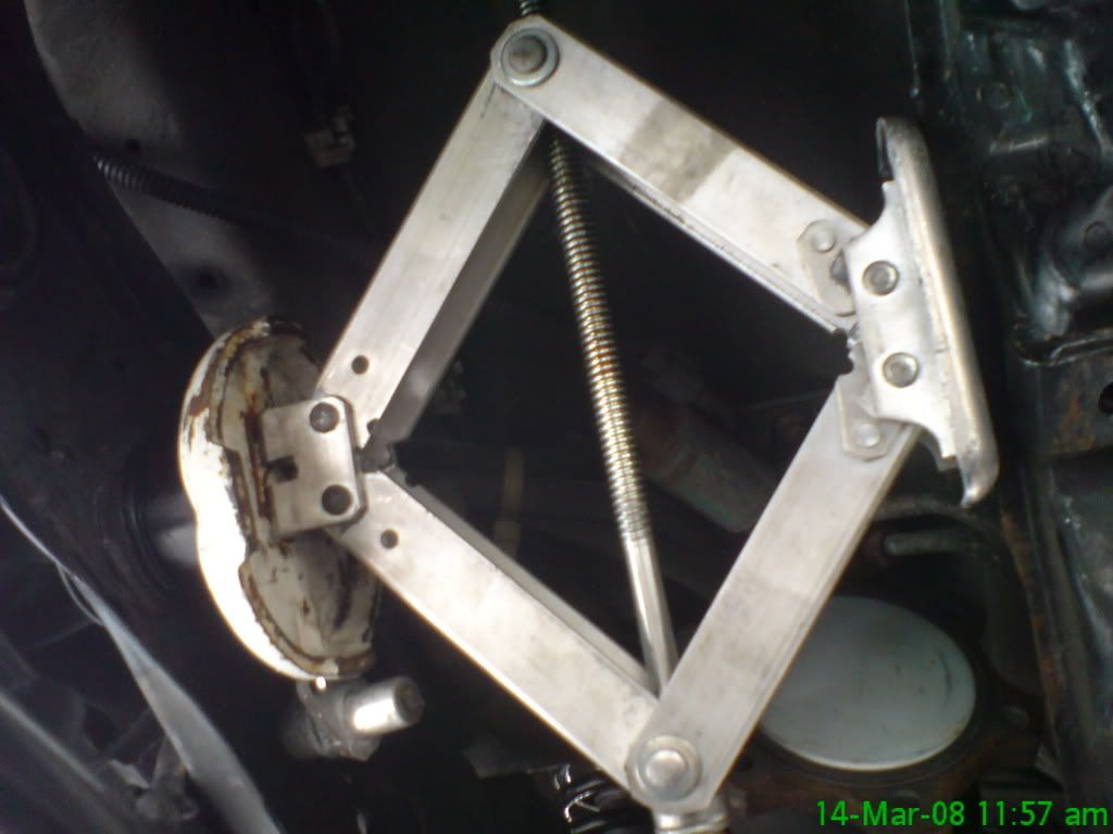

Then I opened the zeds boot pulled away the carpet and grabbed the aluminium car jack that comes with every zed as standard.
I wedged the jack between the stuborn bush, a thick piece of solid metal and across to meet the middle of the subframe. Its good practice to place a bit of wood between the jack and the subframe but i did without and honestly it didnt leave a mark or bend the frame in anyway. See below
I was careful and made sure the long thread on the jack did not come in contact with the body of the car, it was a close call (about .5mm).
Sure enough i began to extend the jack and after a few turns it popped in.
I then continued to extand the jack and squeeze the remainder of the bush until it sat in its place.
vola I gave myself a pat on the back :)
