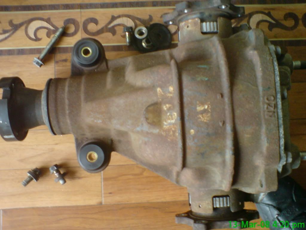

ok i got the diff and the prop out.
new carrier centre bearing and new diff bushings :)
everything is marked up. i got to have a rest now as im off to work soon.

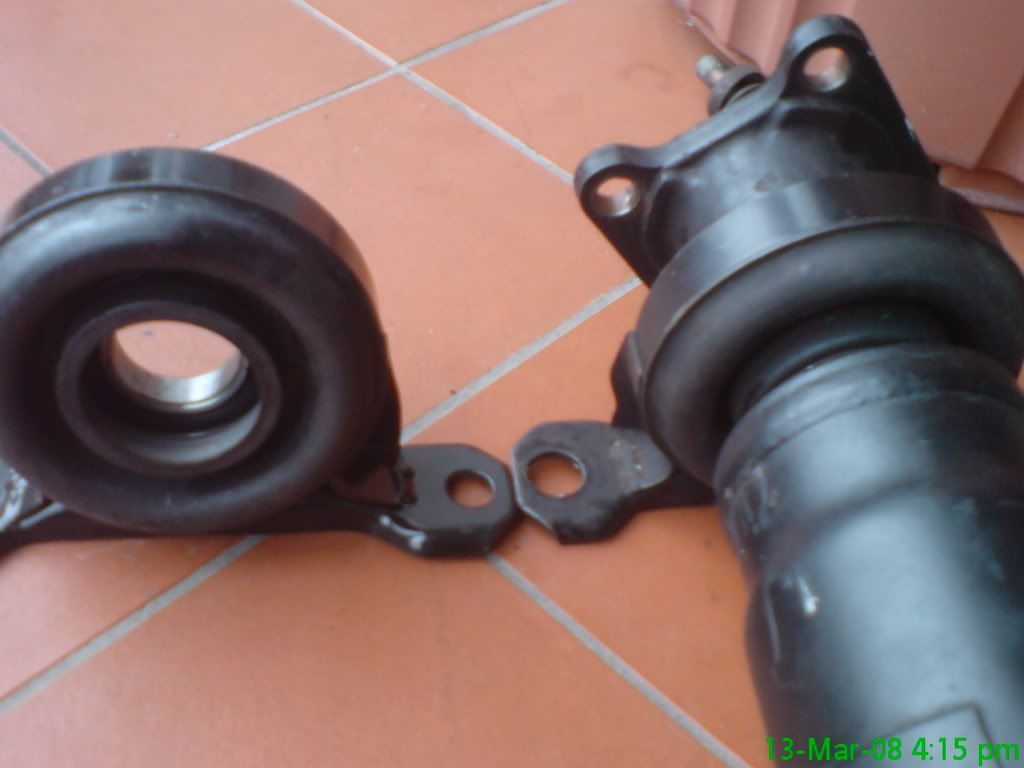

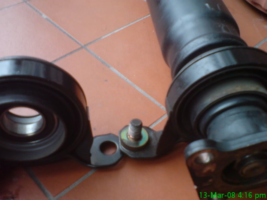

The old centre bearing doesnt look old at all and there is only the slightest bit of play in the bearing.
but seen as the props out i may as well change it :)
