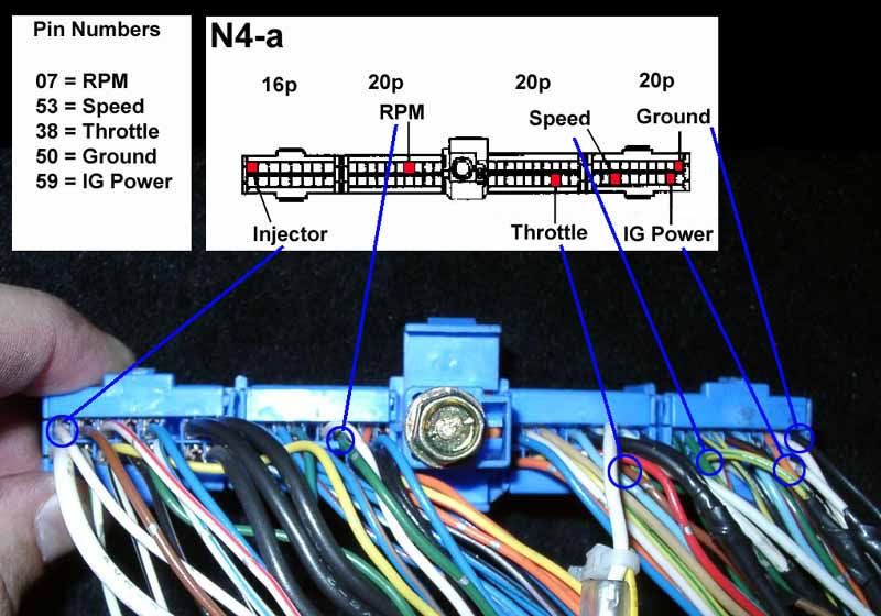

I have recently bought a vehicle dynamics processor for the zed and it says in the installation manual that 1 of the wires has to be connected to the vehicles speed detection circuit. :confused:
can one of you gurus please tell me where i would find this circuit as I am totally lost!
Cheers chaps (and chapesses)
Scotty
ecu in passenger footwell, under piece of wood

1990-1995 Nissan 300ZX Pin numbers for the whole connector
1 Ignition 1 Coil #1
2 Ignition 2 Coil #2
3 Ignition 3 Coil #3
4 AAC Valve
5 A/T Control Unit PW
6 Cooling Fan Relay (300ZX Turbo Only)
7 Tachometer
8 AIV Solenoid (90-92 300ZX)
9 Air Conditioner Relay
10 ECM Ground
11 Ignition 4 Coil #1
12 Ignition 5 Coil #2
13 Ignition 6 Coil #3
14 A/T Control Unit
15 A/T Control Unit
16 ECM Self-Shutoff Power Source
17 Data Link Connector
18 Fuel Pump Relay
19 Cooling Fan Relay
20 ECM Ground
21 Diagnostics Receive Data
22 Diagnostics Transmit Data Switch
23 Knock Sensor
24
25 Wastegate Solenoids (Turbo Only)
26 Mass Air Flow Sensor Ground
27 Mass Air Flow Sensor MAF
28 Engine Coolant Temperature Sensor
29 Right Side Heated Oxygen Sensor
30 Sensor Ground
31 Diagnostics Clock EGT
32 Malfunction Indicator Lamp
33 FICD Solenoid
34 Power Steering Oil Pressure
35 Fuel Pump Voltage Control (300ZX Turbo Only)
36 Fuel Temperature Sensor
37 --- Spare Temp Input Avail, 0-5 Volt
38 Throttle Position Sensor TPS
39 EGR Temperature Sensor
40
41 Camshaft Position Reference Signal
