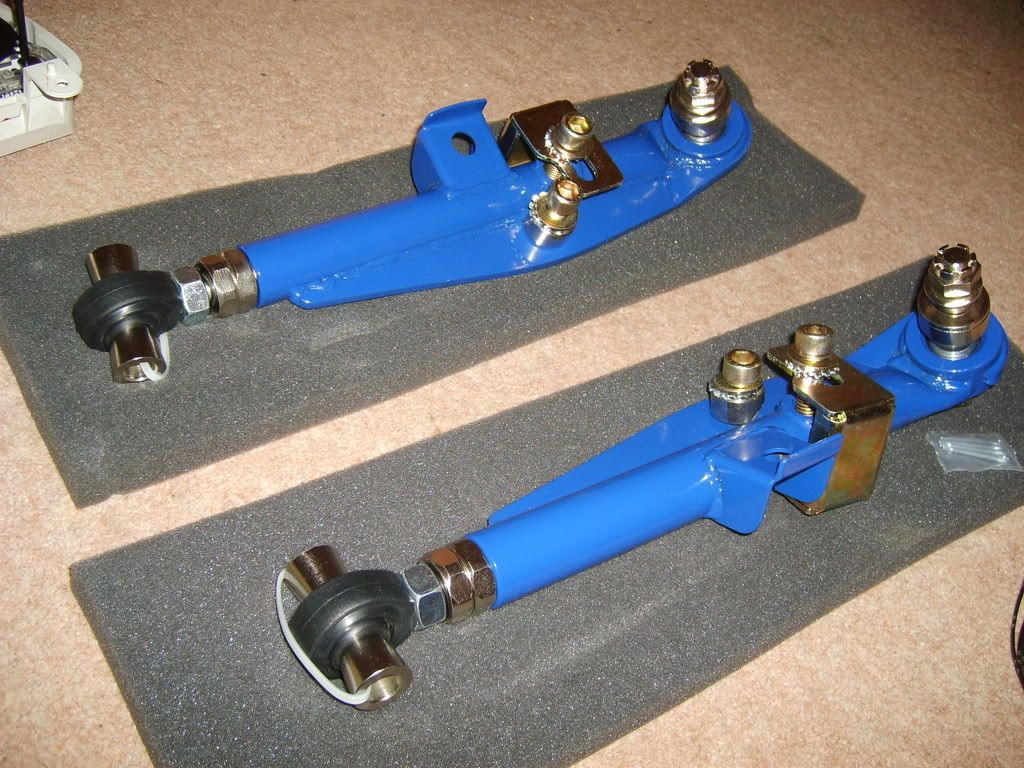

i have!! they are the SPL jobbies.....

$612 without postage, was part of a large shipment. only took 2 weeks from start to finish only because my g/f's credit card was declined so i used my paypal and 2 days later they were here!!

Those arms look like a real brown trouser moment.
You been hitting those kirbs a bit hard again. :rofl:
The new ones look a lot stronger though.

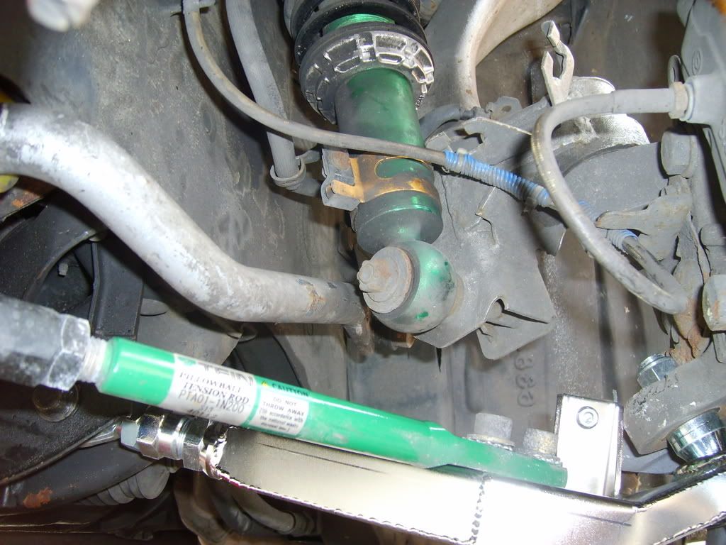

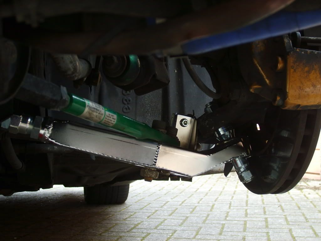

thank fu*k i wasnt going fast Darrel, hadnt hit any thing just poorly made i guess.
i took it to pro tyre and got them to give me 0 degrees toe and 30 secs camber with the caster set slightly forward at 10 degs 50 secs.
she doesnt hold aswell as she did with 1 deg camber but it saves the tyres alittle more.
