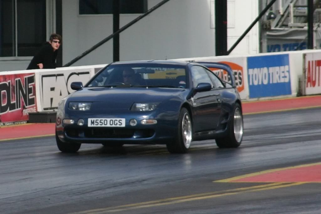

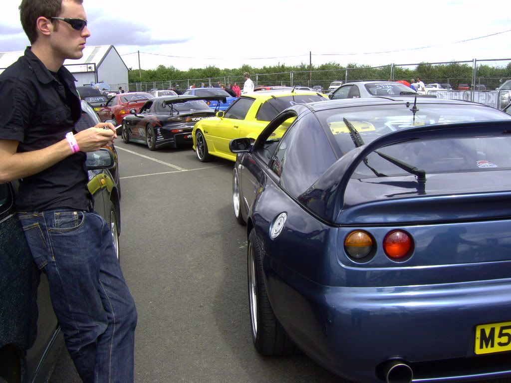

Am I running 245's?? how did you know that? err did you get that from my rides section? if so thats wrong. should have a 245 but is now fitted with a 235 toyo proxes T1S and that looks stretched also but will go back to a 245 when they need replacing.
I dont even know what the offsets are on my rims but have it written down somewhere, will try and find it and post up.
Have a look at this pick of my car at the pod as you get a good view of how the tyres look, they dont look narrow when the cars stationary but the maybe a bit in the piccy. But the second pic you can just see the stretch on the front tyre.
I used my super beady eye to read the tyrewalls!!!!! ;) It is indeed in your rides section!
