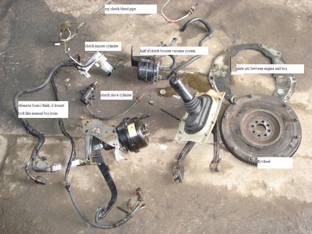

March 7, 200818 yr I have picked up a load of bits for the conversion, I have Gearbox Prop Centre console plastice surround Assorted bolts Flywheel The parts in the picture So can anyone tell what parts are what in the pictures below, I have marked some as present but if you can confirm they are there. I have the list below from the FAQ but am not sure what some of the parts are. Gearbox Got Gear lever Got New leather gear lever boot + 2 rubber boots underneath Master cylinder Slave cylinder All hydraulic pipework Pedal box Got Flywheel Got Pressure plate Clutch disc Throw out bearing Front half of the propshaft Got The plate that sits between engine & gearbox Wiring loom for the reverse & neutral gearbox switches Wiring loom for the alternator Both clutch servo vacumn tanks + pipework Thanks :bow:
March 7, 200818 yr Gearbox Got Gear lever Got New leather gear lever boot + 2 rubber boots underneath Got except the outer leather gaitor Master cylinder Got Slave cylinder Got All hydraulic pipework Got but Dont need - Get a SS braided one made up Pedal box Got Flywheel Got Pressure plate I dont see it there Clutch disc I dont see it there Throw out bearing Got - but get new one (comes with clutch kit) Front half of the propshaft Got The plate that sits between engine & gearbox Got Wiring loom for the reverse & neutral gearbox switches Dont need - modify auto loom Wiring loom for the alternator got Both clutch servo vacumn tanks + pipework got but dont need Looks like you need Clutch kit and a Stainless Steel Hydraulic clutch line. I can label the items on the picture, but not till later when I get home if nobody else does before then.
March 7, 200818 yr you seem to be missing the metal gearbox bracket that the front of the gearbox bolts up the engine with. There are 2 but 1 of them is different for auto and manual.
Gearbox Got
Gear lever Got
Master cylinder
Slave cylinder
Pedal box Got
Flywheel Got
Pressure plate
Clutch disc
Throw out bearing
Thanks :bow:
