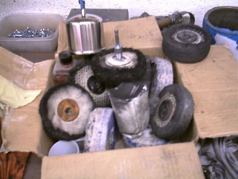

The kit with a fuel filter i polished

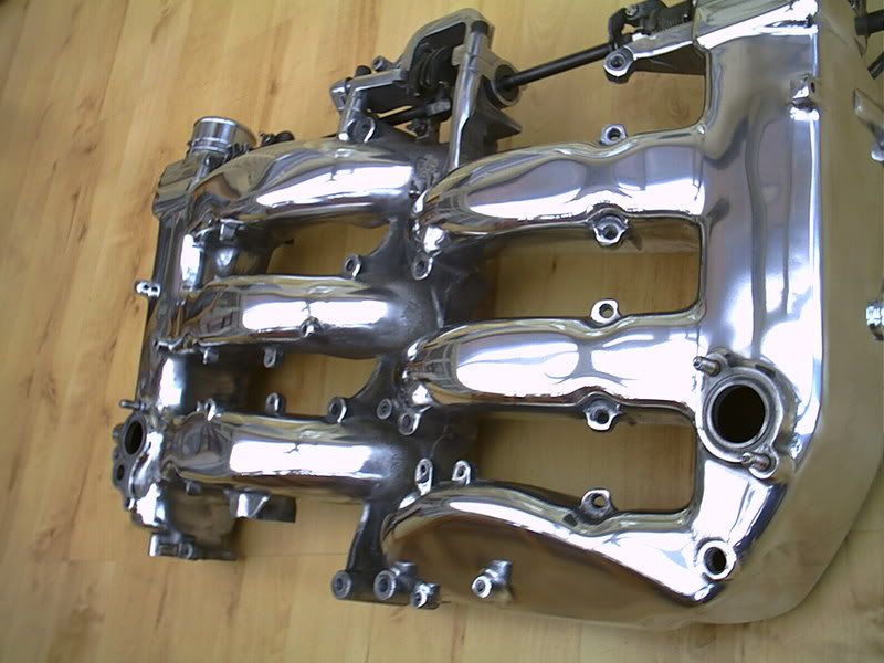

and my plenum :bow:
