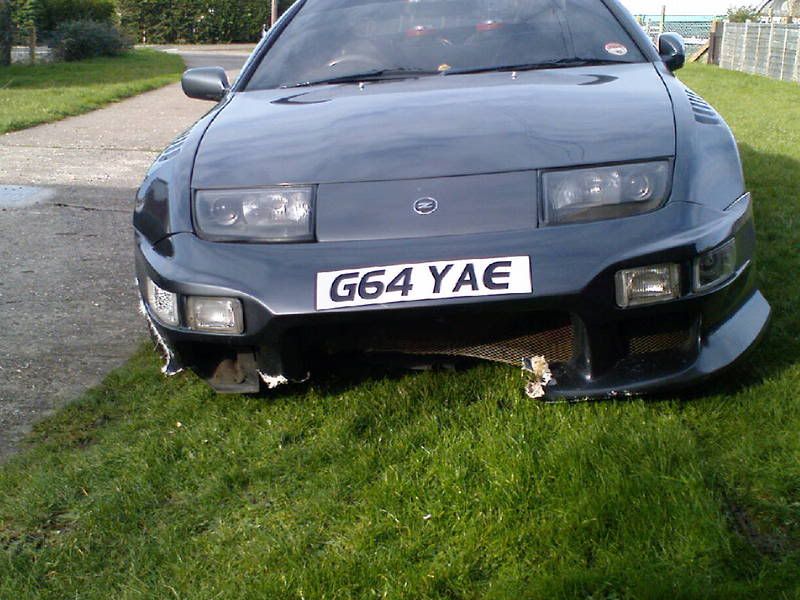

:cry: Was parking my car outside my house this morning when the bast@rd wheels decided to lock up, skidding me right into a concrete step.
