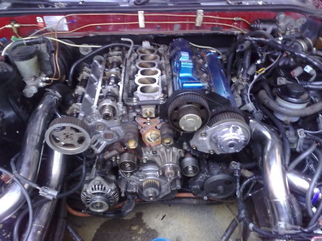

No heads do not have to come off, all connectors and harness on top of engine, coil packs, plenum, rad and cowling, fan, front belts, cas, timing covers, main crank pulley, timing belt, (might as well replace water pump timing belt and idle rollers when your in this far), rocker covers, cams.
ย
I'm sure I missed a few things, it took me 1 1/2 to get to this stage

spent 3 days cleaning tappets

2 days putting it back together which was not as much fun
