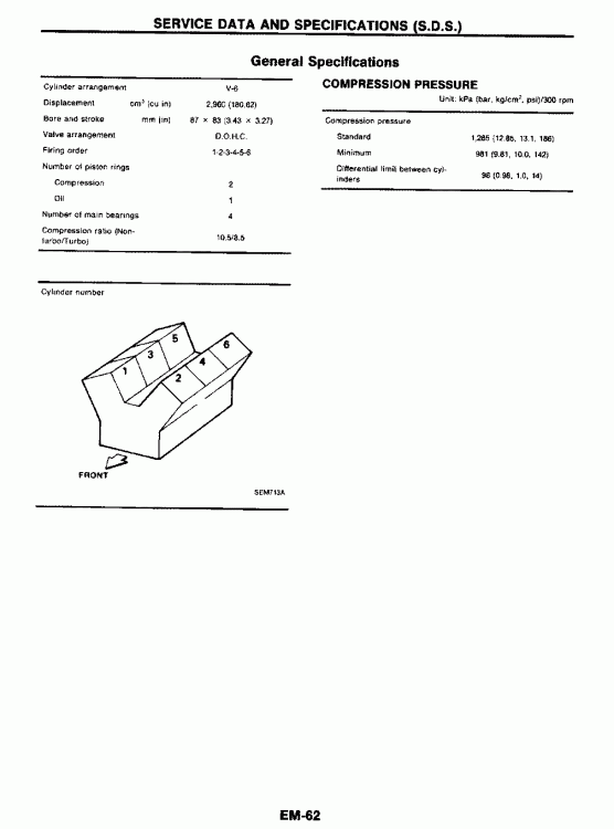

I am getting a "wasted" spark set-up made for the 300ZX as sold by Driftworks... Ben from Driftworks wants to know the ignition firing order on a ZX so he can make up a set for the ZX. Can anyone shed some light:) Thx Lee
Someone will correct me if i'm wrong, but i think it runs linear 1,2,3,4,5,6 down the banks.
correct
