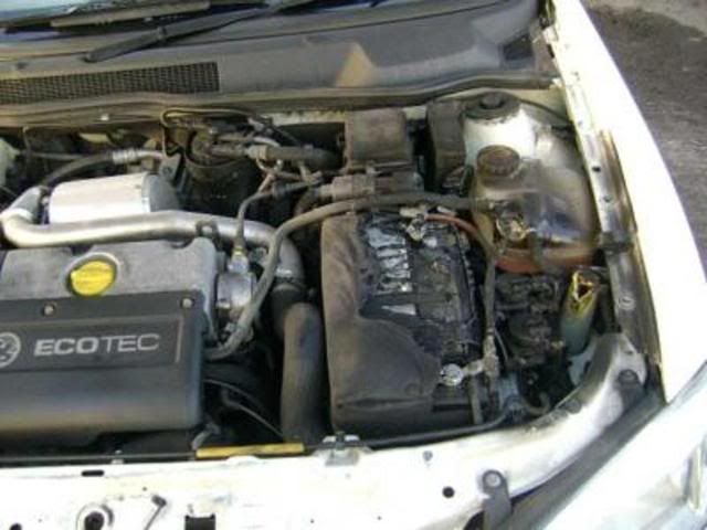

is there a way to tell if it's got the Isuzi lump in it lol, is that for the dti engine or the td. Daz do you know much about these cars etc i could send yo ua pic to have a look at as i've seen one in a breakers and would like some advice b4 going up to the place to look at it

Stick the pics up mate,we'll go from there! ;)
the model is a Ls Dti 52 plate
says light wire fire how much wire is down there where it's burnt? and what are those round plastic things to the right of the battery

The 2.0 litre (as pictured aint' the Isuzu) was crap in the early cars.

Personally yes mate!-been the 1.7 then probably a Go'er.The round plastic things are Solenoid valves IIRC for vac egr etc.Could tell better if I was looking at it! :D
Yes the 2.0dti has major problems with the fuel system.Seen loads of vectras/astras with fuel problems.Usually poor starting or lack of power.the bosch pump breaks up internally and needs a complete overhaul.The cost for a pump iirc is around £700 exchange.
