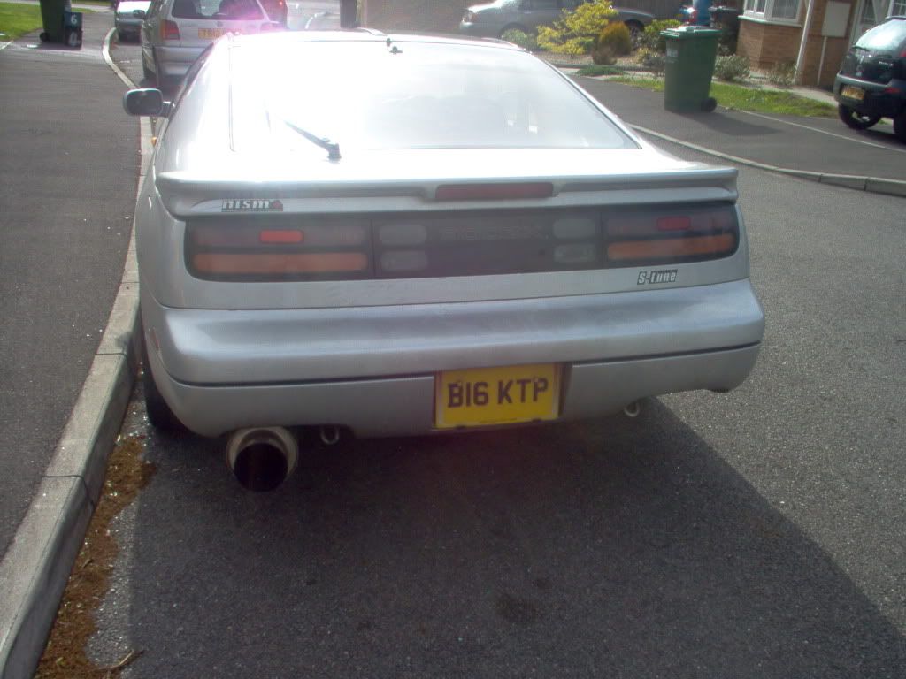

you should be fine, i have found that my single exit provides better back pressure than my old big bore twin but you can never be 100%.

It'll be louder than the normal set up, but so long as your car is a TT it should be bearable as the turbos baffle a lot of the sound. If your car is a NA then it will be too loud and need extra baffles between the cats and the back box.
I know from experience with one of my NA's. It sounded awesome round town or for a short sqirt through the twisty's but 10 min's on the motorway resulted in severe head haches

It will all be fine, just dont remove the cats as this puts a lot of extra pressure on the rear turbo seals and as they are probably years old the will fail and it will smoke alot on idle and engine out job.

changing from a Quad Exit to a Single exit exhaust actually stopped the smoking on my silver car. It was decatted too.
