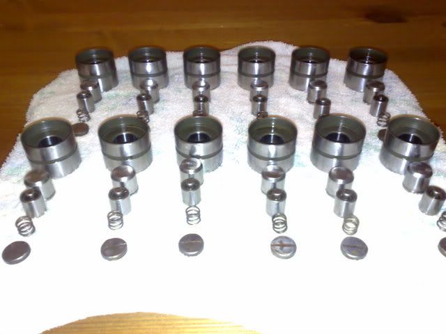

Or if your feeling like a gamble you can take them all out and clean them, I did this as time and spending 2 days cleaning and polishing them was all I could afford, I did have 3 that refused to seal properly on checking them after cleaning I binned those and cleaned up a few more spare second hand ones.

None of the lifters I had were faulty due to debris, 1 had an oval round where the little ball seals against the piston, and 2 were just sticking due to the build up of glazed oil on them, several had the tiny holes in the top washers half blocked.
