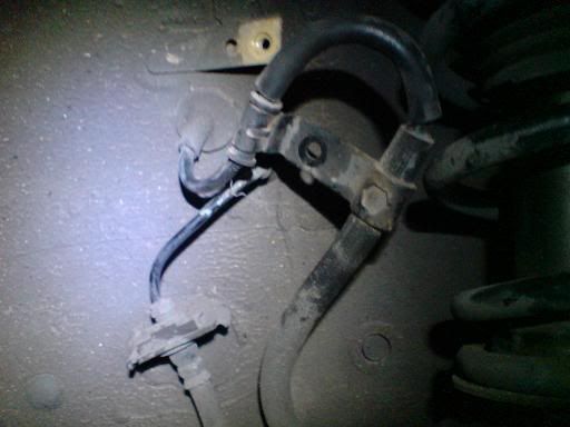

Plodding along with removing the subframe. At the moment i have bled the front brakes and need to disconnect the hoses from the wheel arch that go to the disc calipers. Looks like i should do it near the wheel arch. But i cant get the things off:-
I have already unscrewed a clip from the wheel arch.
Use a crows foot type socket NOT an open ended spanner to undo the nut while holding the rubber pipe to prevent it from spinning. Then pull the clip out and the rubber hose will be free :)
Erm what a crows foot type socket. I have the spanners that are closed with teeth inside that only spin one way.
It's like a socket with a slot cut out of the side.
Sorry can someone give an idiots guide to flicking that clip thing open so i can remove the frickin hose. And how to remove the double ended hose holder. I am a right plank doing some things.
