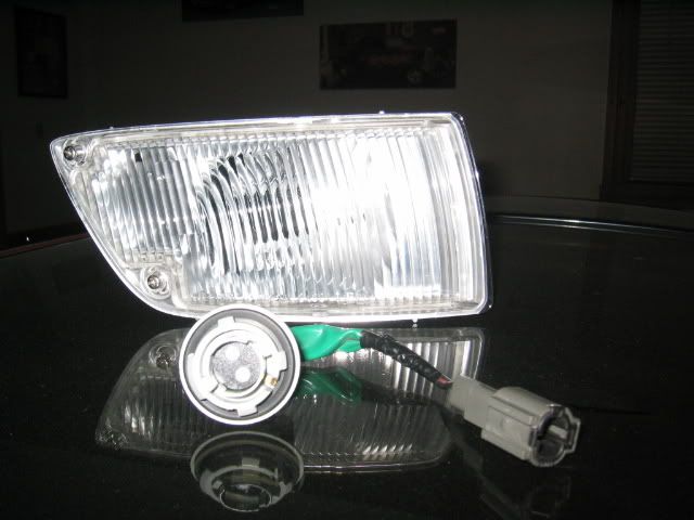

That pic is from a guy that used to clear them in the U.S,he stopped because its so easy to break the lens
You can get them apart by placing boiling water where the tabs are,lift the tab up gently,and then slowly pry the lens off
The hot water or even a blow dryer or heat lamp is to loosen up the black sticky shit so it will come apart
When u get it apart,simply spray the inside white or silver/chrome and voila,its a clear lens

here is what the lens looks like on a red zed cleared

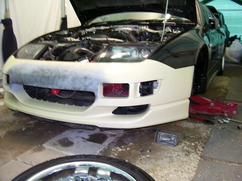

i couldnt get the 99 spec indicators apart,so i just painted the insides of the foglights so now they all look smoked

Was it difficult to do? Presumbably you had to remove the glass. Any particular paint used?
Very easy to do,remove the fog light lens,rip the glare guard out,and spray the backing with heat proof paint.The fogs light up very well still,and as i changed to hid lights,i put my old 55 watt headlight globes in .With hids,the fog lights really dont do stuff all anyway
