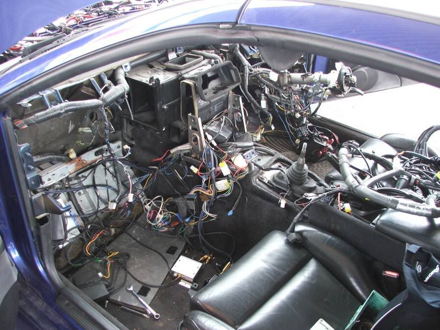

Targe Drain Tube or if you have got a boost controler or the car has had one, then the most comon thing is to route the wiring from the ECU harness straight through the Aircon Drain plug vent Grommit into the engine bay. This can dislodge the Aircon drain pipe and it drips onto the ECU. See pic.

I found water droplets around the bar that sits above the ECU where there is the patch of rust shown in your picture.

is the air con grommet in the picture as the large looking hole to the right and up of the ECU mounting?

No the big hole is where the EFI harness from the ECU goes through the fire wall. The Aircon drian caused the rust on the ECU frame. If you look there is a lable just above the rust and a black grommit just above that. THe Aircon drain should go through that and the grommit has a rubber hose that hangs down the other side of the fire wall.

To sort this you need to remove the glove box, the end cover beneith the dash by the door. The glovebox frame, the ECU cover pannel and the kick plate. You'll then see a white plastic electric plug holder bracket. Unplug the cables and remove the holder. Then remove the rubber that is stuck over the monocock caverty. Whilst you are looking up into the caverty get someone to tip water into the channel at the front of the targa. You'll see the dribble and locate the end of the pipe. Close by you'll see the black rubber 90 elbow the pipe must fit into. Dry the pipe and wait for it to stop dripping. the use a little super glue to ensure it doesn't come out again..
