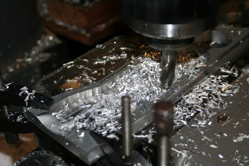

Just a few shots of various ops on the milling machine first, to hopefully show what a pain it all was. Not doing another before anyone asks!

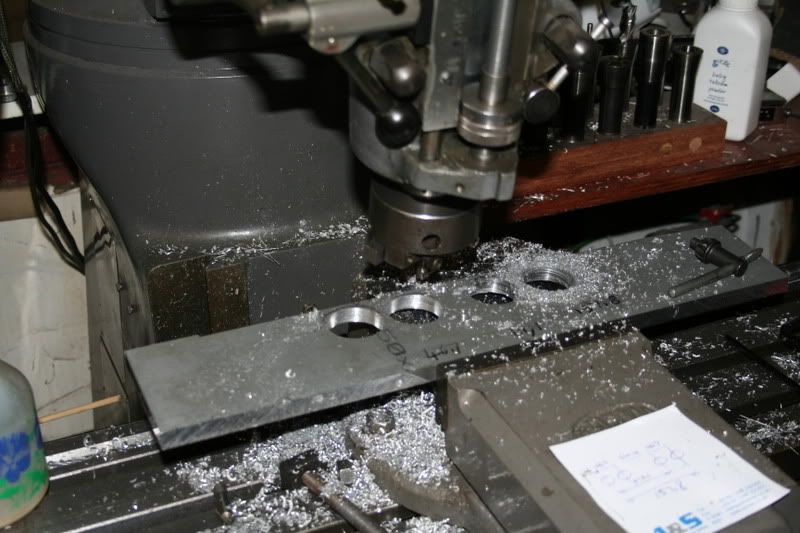

Cutting faces parallel to get a nice datum and create a bit more room

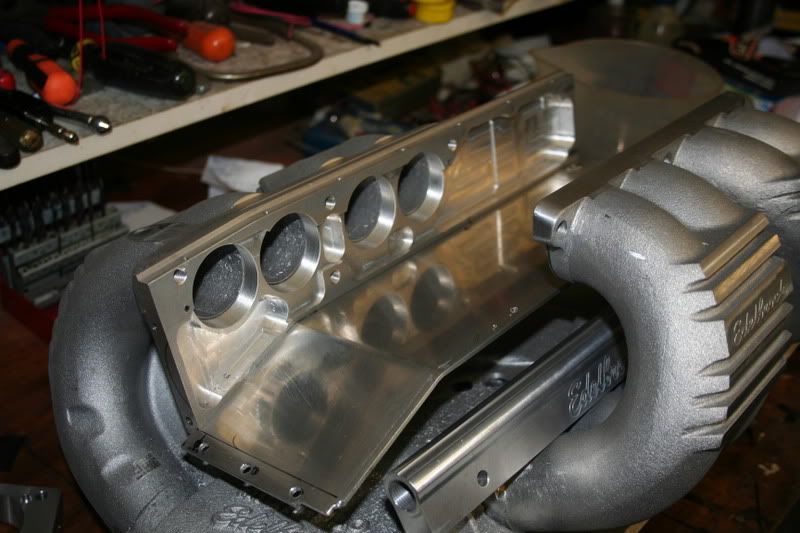

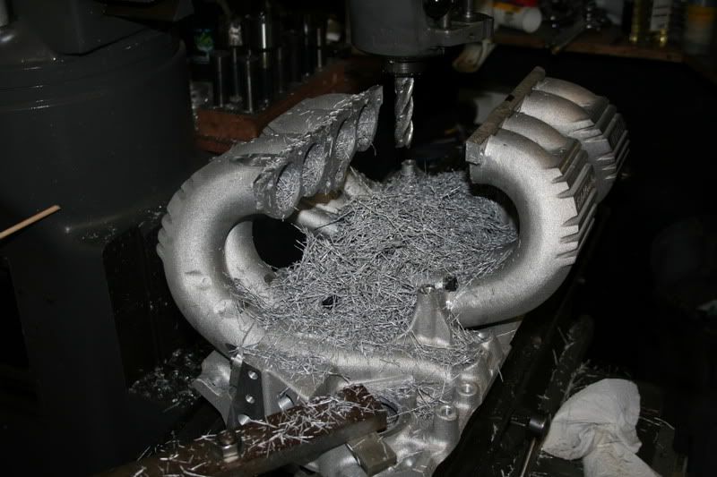

Boring entry holes for runners

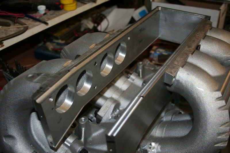

Fitting sideplates
Chobbling away sideplates to save weight
Fitting baseplate

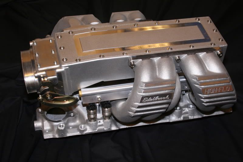

Finished job 2 weeks later, after countless hours on the milling machine, then drilling, tapping, peen texturing, polishing and tarting up the Edelbrock inlet and runners, which were pretty shoddy out of the box.

Better chuck your computer away then, it's going to get a lot better before I'm done.
