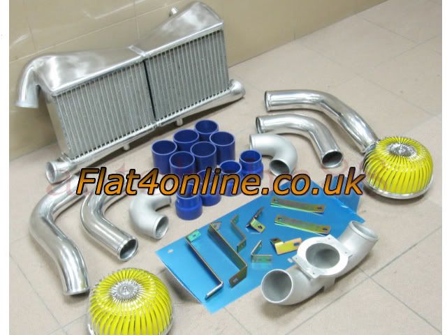

im quite worried now :( does this help in anyway the spec i have
Tabs on bottom and top for easy installation
Improved 15 big bar design with offset fins to increase efficiency
Core size 600mmx300mmx77mm ( 23.7 inch x 11.77 inch x 3.1 inch)
End to end 780mm
Inlet 75mm (3 inch) O/D
Outlet 75mm (3 inch) O/D
Supports more than 650HP
Latest unique bar & blate core design to improve air velocity by 15% over the old design
Fully polished alloy intercooler
Ultra low pressure drop 0.5-1psi at 23psi (Normal Bar and Plate 2.8- 4 psi at 23 psi)
35 % weight reduction
The kit will not only dress up your engine bay but will also allow for the much better flow of air in and out of your intercooler maximizing cooling on your 300ZX

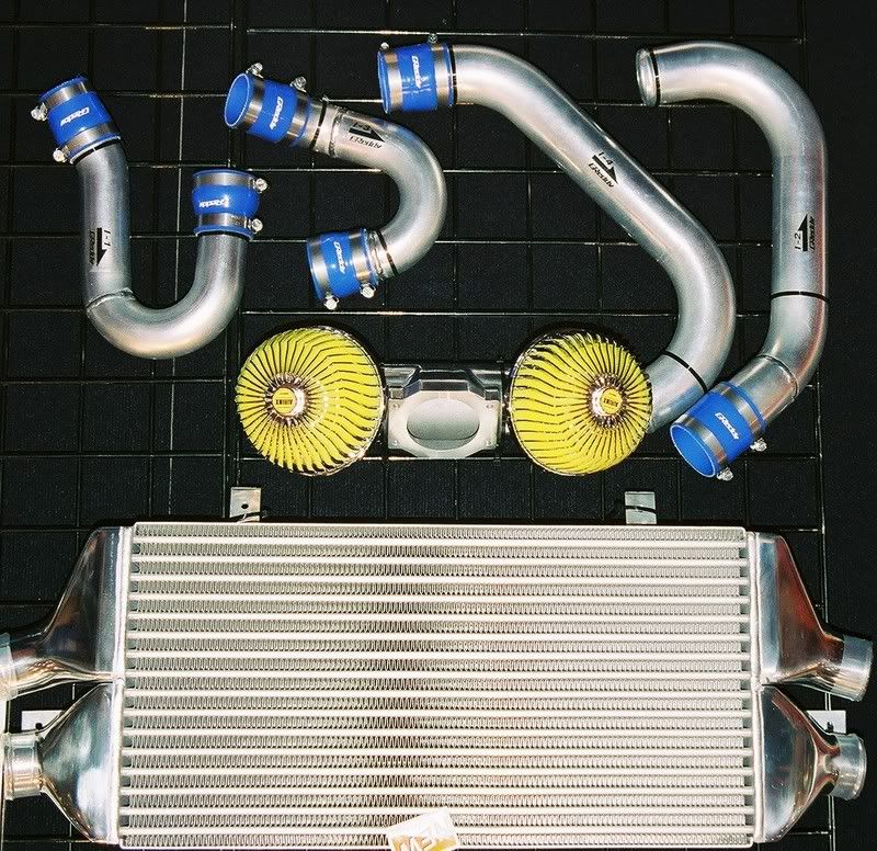

In my own personal opinion yes decent side mounts are superior to front mounts, i know many others feel the same.
In the absense of a definitive test with the same car on the same day testing both front and side mount, no one will ever know a 100% for sure.
Looking at the Zeds intake system which isn't the shortest around nor the straighest either you don't want to make any more restrictions.
In the pic of the kit in this thread it shows 2 bends each approx 160-180 degrees, each one of these bends adds approx 7ft to the length of the intake tract, fitting side mounts adds no extra length at all.
I've seen many tests on different side mounts, ARC ( the most expensive) come out tops due to their efficient cores and the altering angles of the inlets and outlets. Greddy rate highly and the Z1 Motorsport ones flow tested to be about the same, that said there are a lot options around these days.
I actualy manufactured around 150 sets of pipework for the S13 FMIC using the saab coolers, longest pipe was about 18ins to turbo and the shortest about 10in with a 45 deg bend to the TB, hence why they perfromed quite well over stock.
Also done in the past 8 years cooler pipe kits for Evo's, Scoobies, Pulsars and Skylines which kinda gives me some experince in the workings of Intercoolers :)
Hope that helps

ive also got a koyo rad on the way will this help or not???
plus wots the difference between this pipework seems to have as much bends as the autobahn. im not trying to prove you lot wrong as i know u know alot more than me just after ur advise thanx
noticed theres two extra little bends which looks like they replace the rubber hoses near the original ic which looks like a bonus or maybe not :rolleyes:
dnt know how true this is but im gonna email him :rolleyes:

Yes having a KOYO will help some, but bear in mind the whole process of cold air being forced into the Rad is gone when a FMIC is fitted because it is passing through the I/C 1st, what comes out the back, is not as cold as what went in the front. Cooling is something Zeds are kinda tempermental about at the best of times :)
