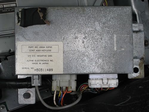

I think the reciever is under the wooden pannel in the passenger footwell
possibly (complete guess) this as it doesnt seem to be anything to do with my stereo:

That does look like a "keyless control assembly".
I'll have to look under me Zed's floorboards LOL.
