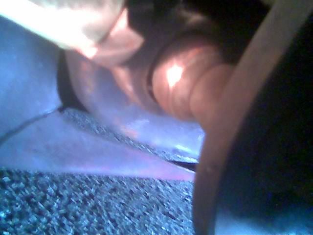

Here is a picture i just took of it. you cant see it well but it is unseated.
Can I buy a single rod or do they come in pairs? I dont know the make but they look slightly different to the ones ChrisC posted with a green hexgaonal shaped shaft.
Once i get it is it easy to remove the old one and fit the new one myself? does it need any adjustment to be the right length or is it ready set up?
I've seen those green ones before a long time ago but I'm not sure on the brand.
I don't think anyone sells single ones so you'll have to get a pair.
Smithy is about the cheapest and always gives good service:
http://www.smithys-place.co.uk/susp.php
I just got a set of those myself and they are superb quality.
You might get something a fraction cheaper off eBay but I wouldn't trust them as they're a fairly critical suspension part really.
They are dead easy to fit but you will need to get the wheel alignment done after as you don't really have anything to measure it against with the old one being broken.
You could adjust it to roughly the right length but you might end up with more tyre wear and expense in future.
