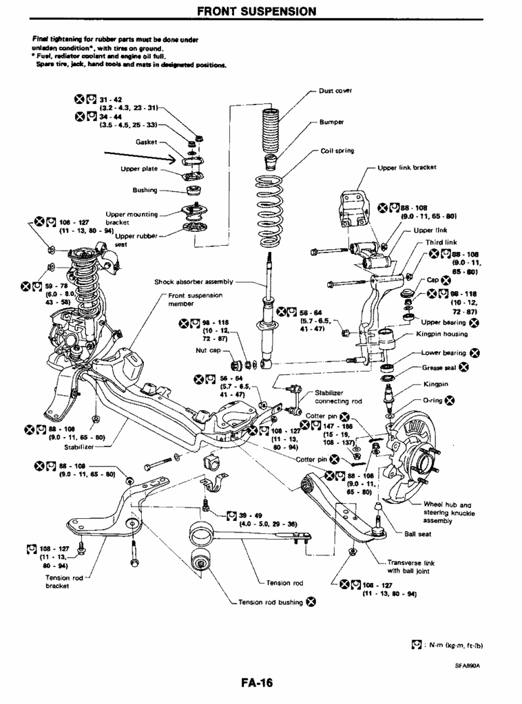

I am going to be changing my suspension this weekend, and i was just looking in the manual at the front suspension and there is a gasket that goes between the top mount and the suspension turret, see pic below i have put a arrow to it. Question is what do they do, are they important and what are they made out of? any info would be great Cheers Jay :duffer:
You can see the gasket on a lot of cars as they tend to be a bit out of place - they're paper as far as I remember. So if desperate you could cut one out of a sheet of gasket paper (or a Weetabix box LOL ! ).

they're a standard nissan gasket, so should be available from stock at main stealer - part numbers:
Front - 54329-33P00
Rear - 55338-35F00

if you cant get hold of the gaskets fella use abit of mastic, its only a paper gasket, ive whacked abit silicon sealant around the top of mine so didnt have to take the damn things out again, hence the sqeeking has stopped.
