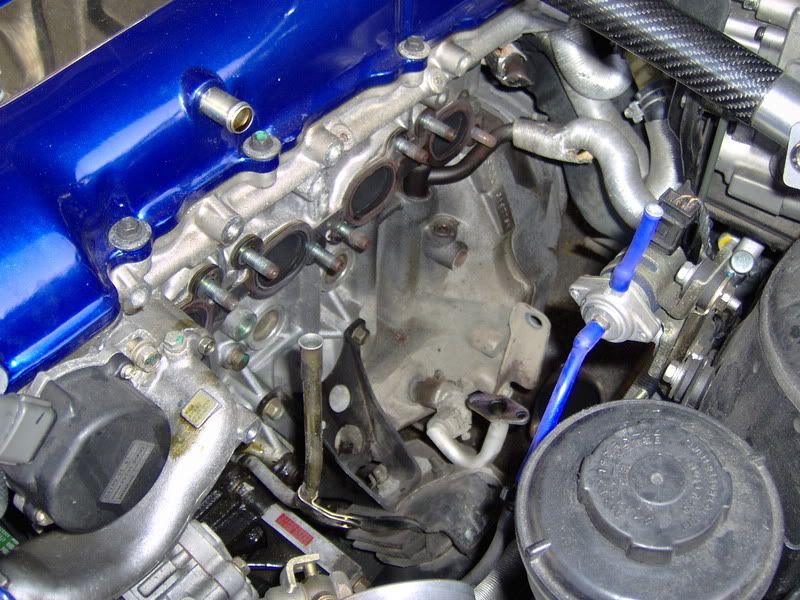

my s14a is up for sale, and sods law there was a blowing noise from the turbo region, and slightly down on power, So 1hr 30min later with turbo off

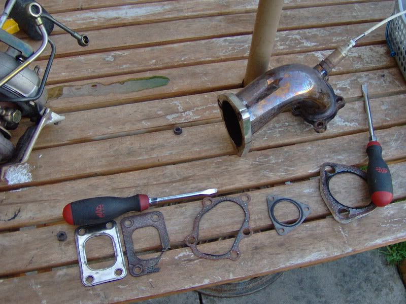

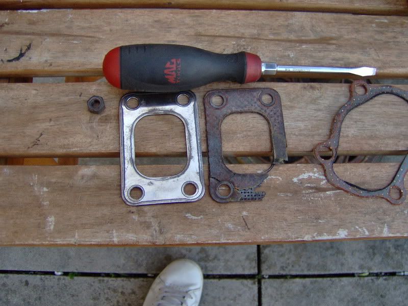

i find this.... :shock: old and new gasket back to back, now has solid metal one fitted
fortunatly the 300zx turbo-manifold gaskets are much better quality, you would not want to take the engine out every 55k miles LOL

Nice lookin motor there Greg.. seems to be a common fault on the S14a's i used to get thru a turbo gasket evry 6 months .. was fine untill i started to tinker with the boost pressure :rofl: :rofl:
cheerZ, Yes is a common problem, although the thickness off the new gasket iv fitted should outlive the turbo and the car, i should expect the outcome running 1 bar of boost :D
Greg, where did you get the solid metal gaskets from? Will be changing the turbo elbow and exhaust soon, so I figured I may fit some decent gaskets in the process.
its pretty much standard issue mate, i used a t25 gasket as there all universal to majority of turbos even out t28, so just order a genuine nissan 300zx gasket from mike feeney, there around £15.00
