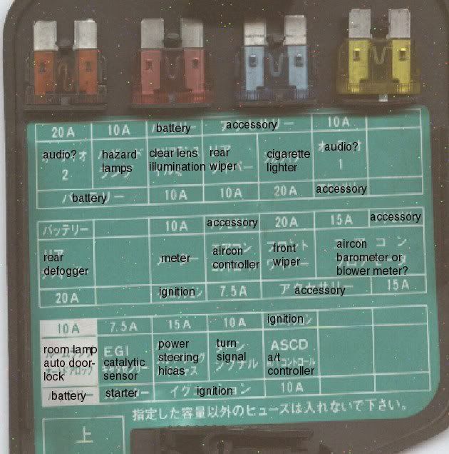

For some reason my stereo(s) have no power at all now, the clock is kind of blinking between dull and lit and the interior lights do not work.
Most likely blown a fuse/fuses? If so which one is for the above?
It's a jap spec TT. Ever other electrical part is working fine though.

I've looked at the 2 audio fuses and they seem fine. I've booked the car into an auto electrician next Tuesday as i'm selling the car so needs to be done.
Anything else I can try in the mean time?
does your passenger side door lock work on the central locking? i had the same problem as you've described and it was a fuse. can't remember which one but it was in the drivers side footwell.

Chris,
Have you checked the bottom left corner fuse (as in the pic above)? Just give that one a try before you spend money with an expert!! ;)

I had a feeling it might be that after coming back and looking at the fuse diagram again. No the central locking isnt working.
I'll check the fuse and report back, thanks.
thought so. thats exactly the problem i had. pretty sure the bottom left fuse us the one i changed.
Your a star, was that one, replaced and is fine now. I didn't have a 10 fuse so i've had to put a 15 one in. It's working fine now.
